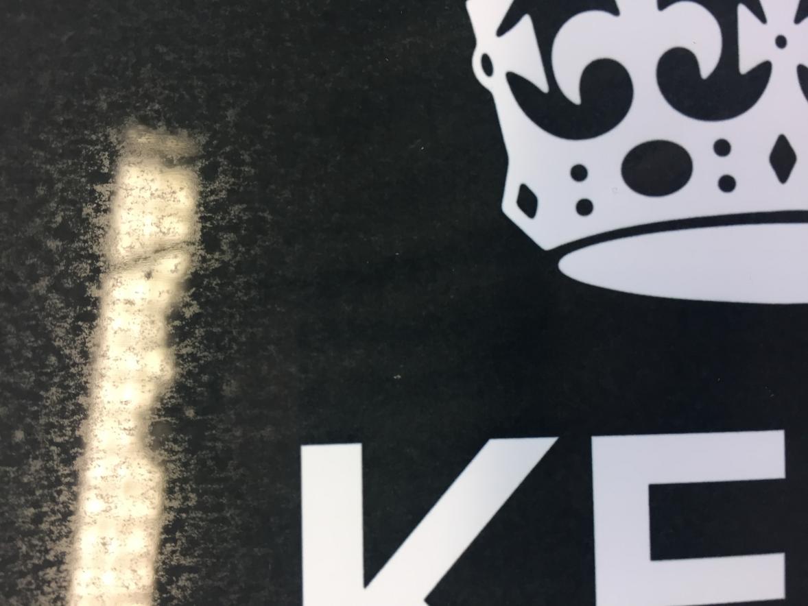

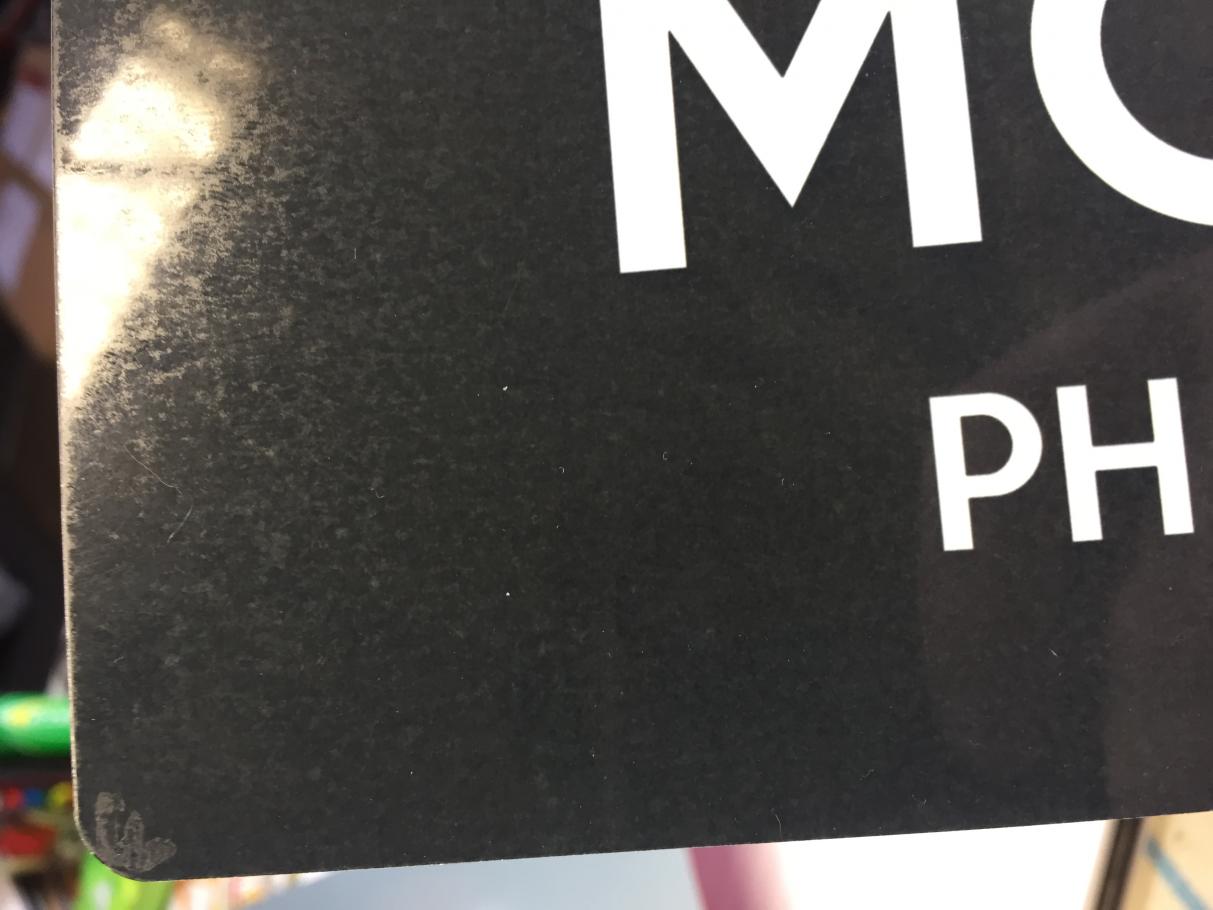

Hi there,
We have developed a problem printing metal sublimation plaques / signs.
It tends to be when printing solid colour backgrounds, especially black. The surface has a mottled effect with a ripples in areas and tends to leave a washed out paler colour.
She attached examples.
Any advice would be a great help.
Mark
Mark

I believe this is moisture in the material. I have read on here that some people press through the metal with a sheet of kitchen roll to take out the moisture
Re: Problem printing metal sublimation plaques / signs
What time and temp? Usually I would go for too much heat on this type of thing but the bottom corner on 1 image makes me question has the plastic covering been removed? if so, try dropping time or temp a bit.

The film is definitely being removed but the problem seems to still be there, it's only solid colour backgrounds. if it's a background picture it's generally fine.
Could it be a fault with the heat press perhaps?
Just an idea never tried it myself. Try pre pressing the panel with some kitchen roll.
