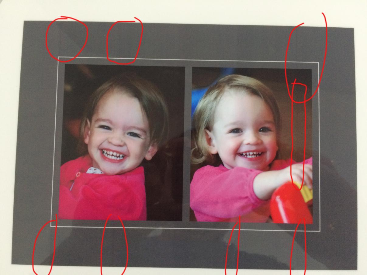

I have a NEW Sawgrass 800 Printer using Magic Touch Paper (DyeSub Magic)
I've noticed banding, and the banding is still visible when pressed onto a coaster.
I beginning to think its Magic Touch Paper, what do you guys think?
