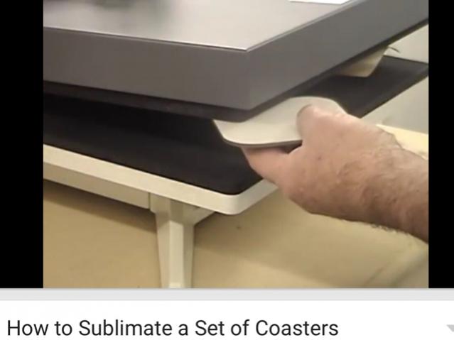

I watched a video in sublimation and noticed that they gently pressed the time to the top plate of the what press and it's just enough to to release those protective sheets and makes it so much easier to pull off. Certainly saved me when I did a 60 coaster order.

Developit;104625 wrote: that they gently pressed the time to the top plate of the what press and it's just enough to to release those protective sheets and makes it so much easier to pull off.
Please do not take this the wrong way but I what are you trying to say here?
Do you mean they pressed the item first without an image to release the protective film?

I just tapped the coaster to the top of the press and it just released the plastic film a tiny bit and made it easy to pull off.
Here is a screenshot of the video and a link showing what I mean.
[ATTACH]3704[/ATTACH]
