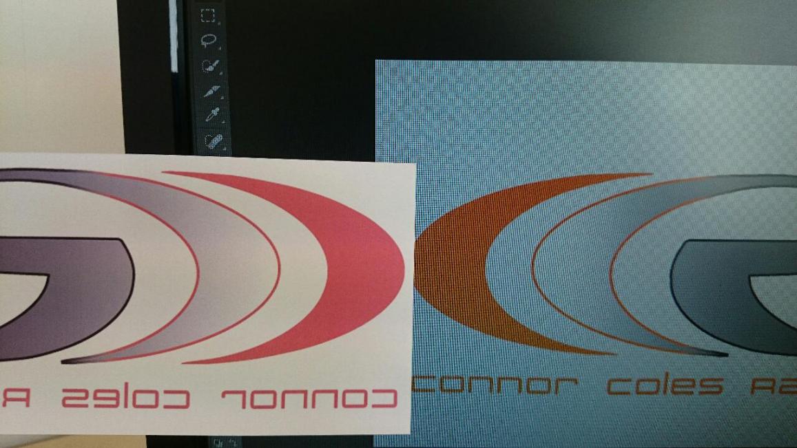

Hey All,
I haven't had any real issues for a while but today I went to print and something's not right.
vB_ID:3391
vB_ID:3391
It's not the greatest picture but on the left is my print out which is red. On the right is my screen which is orange (it should be orange).
This has never happened before - I've never done any kind of custom ICC, just installed drivers as directed on the Sawgrass website and it's all been fine up until now.

Do a head test print to see if one colour channel is blocked.
Photoshop is a right pain with colour printing it keeps wanting to use some stupid american setting that cocks colours right up.

ArferMo;100365 wrote:Do a head test print to see if one colour channel is blocked.
Thanks ArferMo - Head test completed - No problems there so that's not the issue.

Don't forget if you are using a windows PC that you probably had a BIG update yesterday and that could have changed some of your settings.

Thanks again - I don't have Auto-updates on so no changes there either.
Re: Ricoh 3110 - Orange is Printing Red
What is the colour breakdown?

Ooh - I have just noticed - When I use the colour picker to select that orange there is a little exclamation mark on the RGB colour slider (on the right) that says "Warning: Out of Gamut for printing". No idea why or how to correct it though?

socialgiraffe;100370 wrote:what is the colour breakdown?
r = 255
g = 89
b = 33
There is your answer, change the colour slighty so it falls back in the range.

POO- I got all excited thinking what a simple fix but All Gamut is now in range and still same problem.
