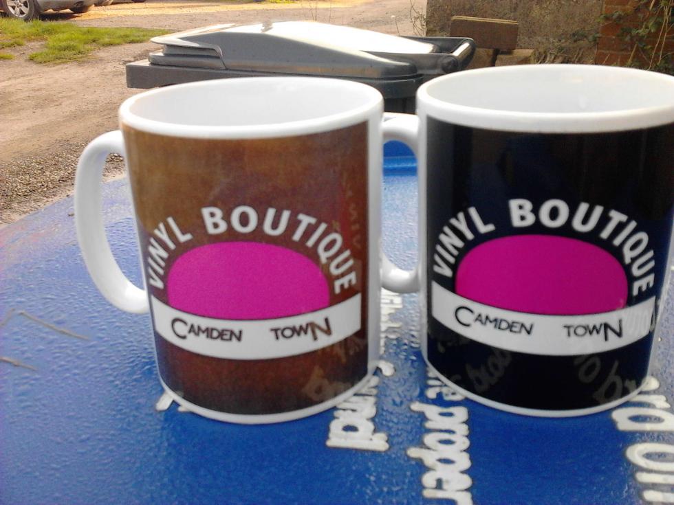

I've got a sheet I printed nearly 10 hours ago and it is still not completely dry. When I pressed one, the colours were great, unfortunately because it was not totally dry, there were smudges.

That's what I thought, but the mug on the left was the result. Mug on the right was using a slightly damp print.

Time or temp is wrong then, mug press or oven ?
