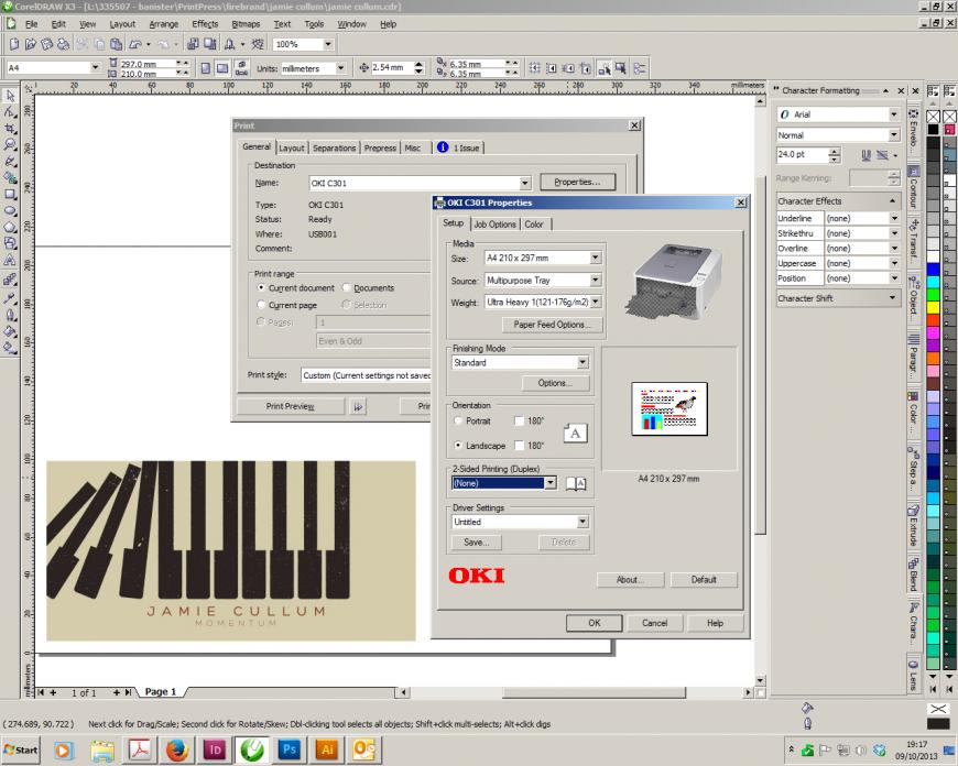

Re: Yolo v TMT v xpress v etc
Hi Justin
is it the settings that you are having problems with?
here is a screen shot of the settings I use for the 301
[ATTACH=CONFIG]1990[/ATTACH]
