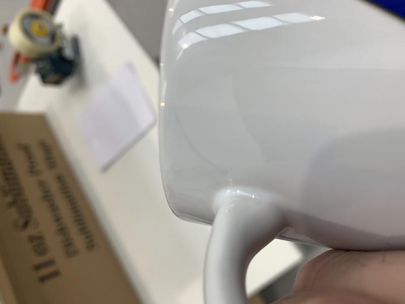

So, we’ve just done our first big order in the blizzard oven. Quite a lot of blue so we had to bake the mugs at 170 degrees for 25 minutes. Results were really impressive, however, as noted previously we found the design ended up on the silicone wraps.
This didn’t seem to have any effect to start with but after about 250-300 mugs (so about 7 mugs per wrap), we started to notice the print that had ended up on the wraps was ending up sublimating onto the mugs.
I then put the oven on 300 degrees to clean the wraps and then we started getting the blue tinge on the mugs (as shown below). Any ideas how to prevent this in the future?
We has some new wraps available so used those to finish off the order and have now had all the wraps in the oven at 300 degrees to clean the print off them.
