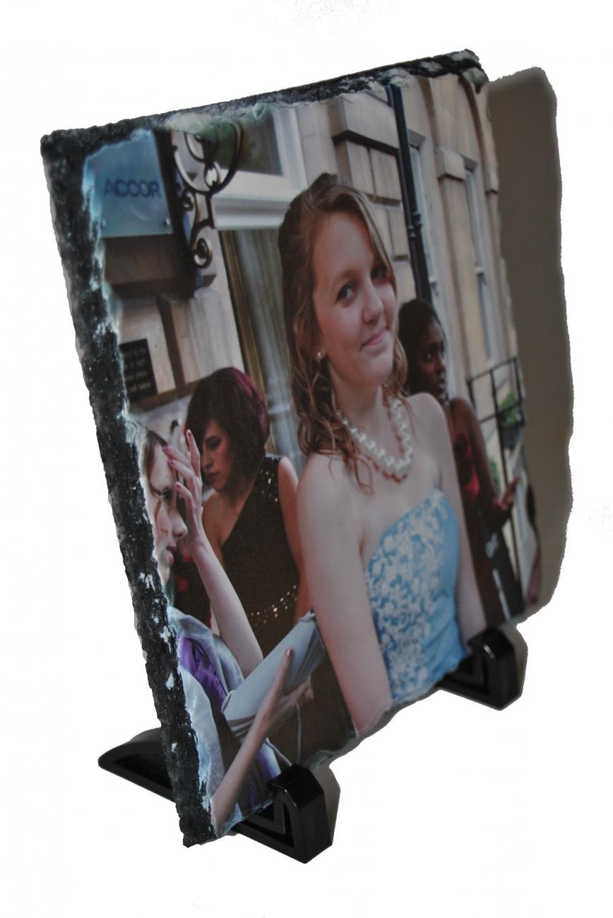

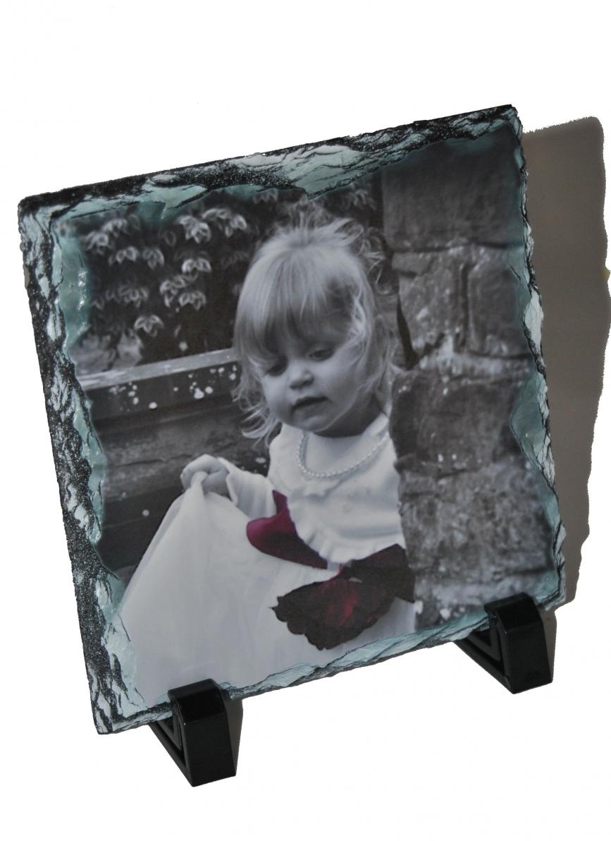

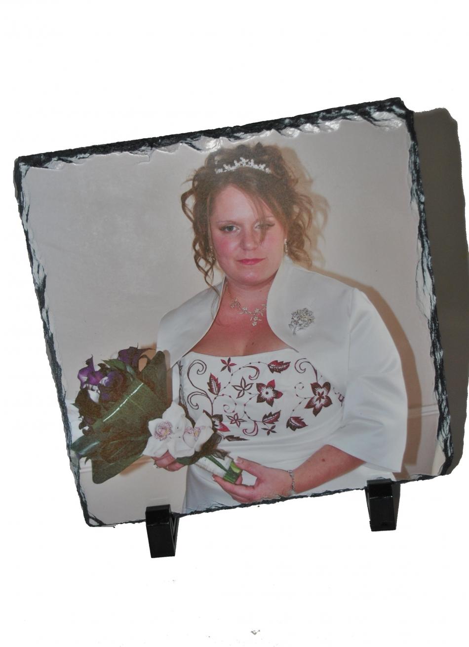

[ATTACH=CONFIG]630[/ATTACH][ATTACH=CONFIG]631[/ATTACH][ATTACH=CONFIG]632[/ATTACH]
These are my first attempt at ones received yesterday from Coralgraph. After they were done there were a few areas that didn't look as if the ink had taken but it was gone from the paper. I actually threw the first 2 in the bin then when i did the third it was the same but as i was going to throw it anyway i wondered how quickly they could be cooled (and would they of cracked like ceramic will) so i put it in a bowl of warm water and when i took it our i noticed that the faded areas had gone!!!!!! Turns out the faded areas were just a very fine layer of the paper still stuck on the front which came off when wet. I fished the other 2 out and Woop woop they looked fine after.
Do you think they look ok?

Re: sublimation slates
lovely pieces schizowife !
I had this same with them
I thought there is something wrong with them but after cleaning them "fade" gone! it was bit of paper coating sticked to them
I am glad i worked it out as now i have lovely slates
