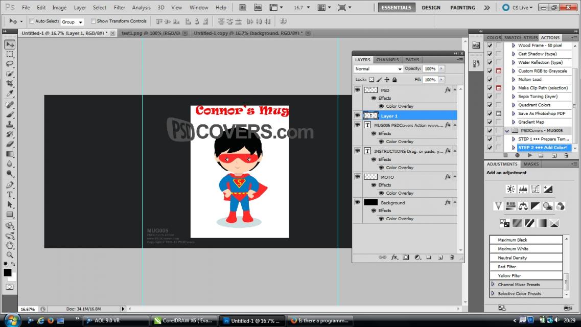

Hi Karen, ok I did the transparent png so that the black background from the mug shows through and just did the eyes so the text disappears but how do I get rid of the black background? I clicked the eye against this before to get the white and grey checked background?
In Coreldraw I did export, selected png and unticked transparency and opened in ps and did select all and copy and paste and it looks like the below. It's the second layer down.

Re: Is there a programme that i can use to show what the mugs will look like before print
All I do is extend the white background of your original picture so that it fits the template, move your picture up the list so that is at the top and the text will disappear.

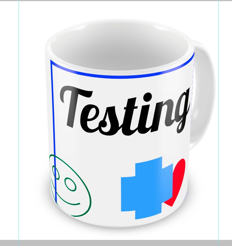

Hi Lianne,
Yes, your pic 2 replies ago is what I would expect.

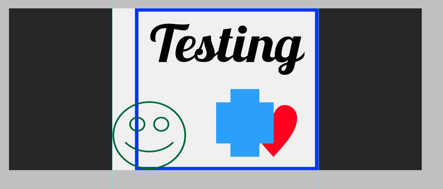

Now you need to create a larger image in coreldraw so that the imported pic fills the centre section of the template.
To stop the background being too white, fill the background with an off-white colour - say rgb 240 240 240 - before exporting as png.
Here's my test file imported into PS.:
[ATTACH=CONFIG]2900[/ATTACH]
Here's the resulting mug:
[ATTACH=CONFIG]2899[/ATTACH]

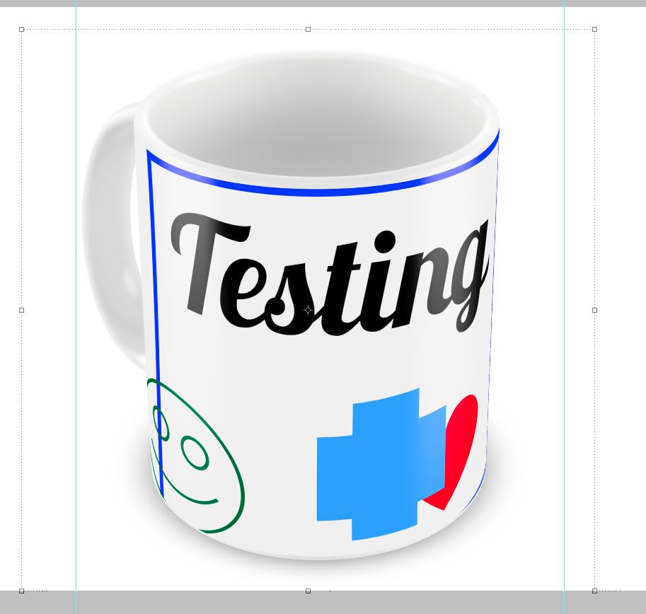

Now to change the handle - takes a bit of sideways thinking.
First - when you've pasted pic into PS, transform layer by flipping horizontally.
Then render.
Then flip canvas horizontally again
[ATTACH=CONFIG]2901[/ATTACH]
