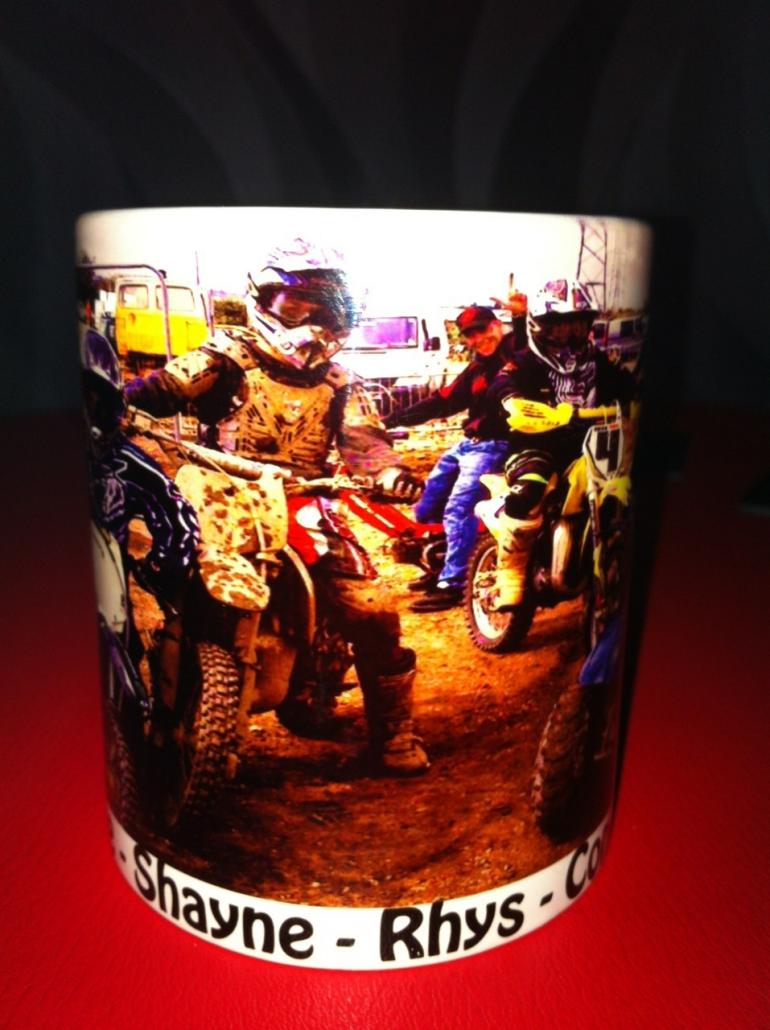

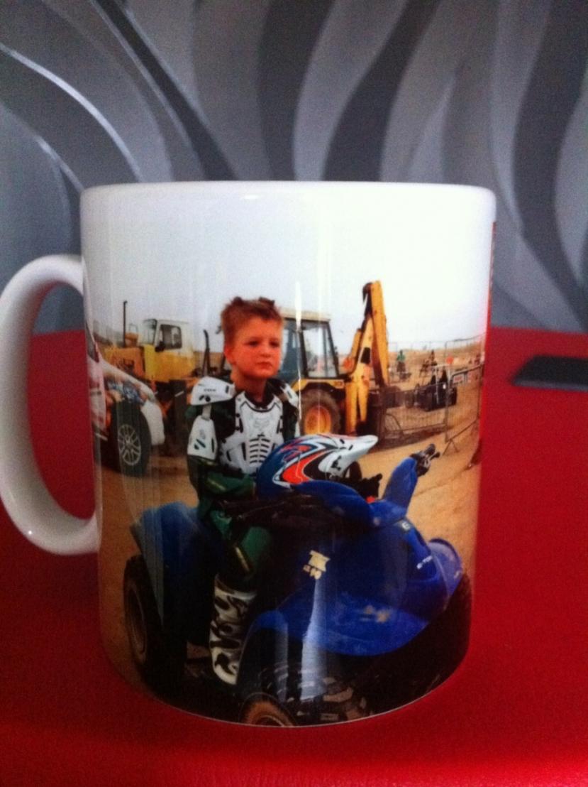

as mentioned earlyier here are the results from the recent mug pressing.
This first one is using the profile without any alterations to the image.
[ATTACH=CONFIG]1160[/ATTACH]
This one is using same profile but changing brightness up by 90 and also contrast to 30.
[ATTACH=CONFIG]1161[/ATTACH]
Paul has made some changes to profile to lighten the print which i have not had chance to try yet and when i do will edit this post so i have a comparison. But atleast the images are looking good on the mug and it is being pressed correctly.
