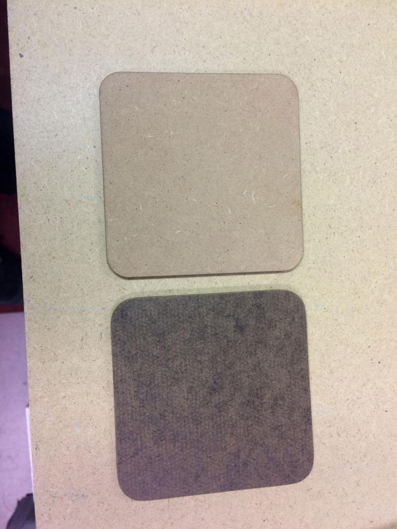

Just tested these coasters from Sole Juice linked below. Quality of these seems very good. Possible not quite up to Unisub but not far off. Reverse on these is lighter. I tested removing tape whilst warm and also cold. Very little noticeable damage. If I'm being critical there was a slight mark but I doubt most would notice.
I'd advise getting a few to test with your own setup, tape etc. but works well for me.
I mentioned that I'd tried the Subli Blanks ones as well with a black back. These weren't as good and appeared to snap quite easily but on the upside the backs don't mark when the tape is removed!
Image below shows SoleJuice coaster above the Unisub, SJ coaster has been sublimated and tape removed cold here.
vB_ID:4929
vB_ID:4929
