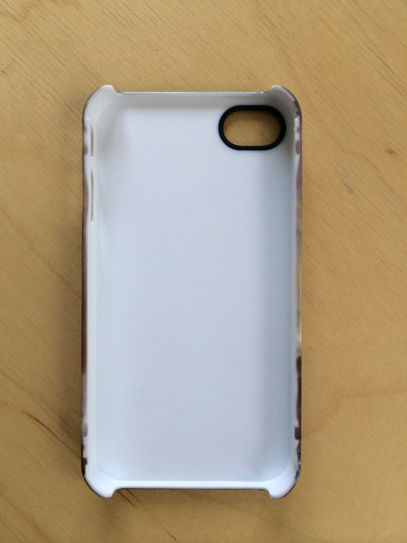

I've got the same issue with the corners. But I believe the reason for this might be a different paper or different vacuum pressure. I fixed the issue with the corners by using film instead of paper. But I really cannot understand how you all manage to print on the front edges of the case. Please check the photo below.
[ATTACH=CONFIG]2866[/ATTACH]

The printed edges are likely not taking the ink because there may not be enough of an overhang of paper below the sides of the case. I'm happy to make my templates available for others to use - is there somewhere specific for me to upload them to, can anyone let me know? Certainly, if the paper is low enough (literally just 1mm-2mm beyond the size of the case) then the ink will be pulled into the edges... assuming your vacuum is powerful enough and doesn't have poor suction, of course.

Thanks for your reply, I really appreciate this. As for the front edges I actually tried to print a huge image that is waaay bigger than a case. The result was the same. Perhaps I should look into vacuum strength and/or mold shape.
