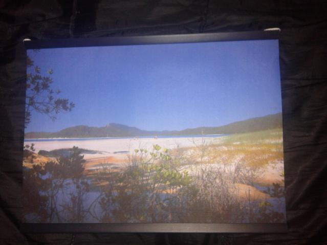

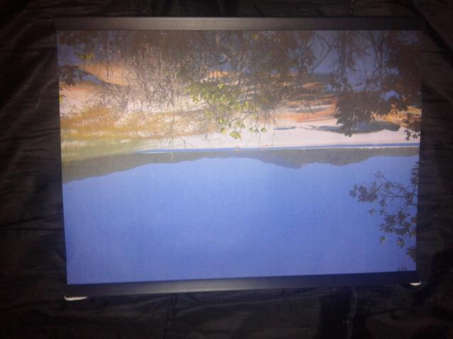

My First Canvas - is it ok ?
Re: My First Canvas - is it ok ?
Kind of confused here. The qualityof print on dye sub paper with subli inks is very dull but transfers onto whatever nice and bright. So wouldn't your canvas look dull because you aren't transferring the image, just using the print that comes out of the printer, which would be dull like a print on dye sub paper? Does that make sense or am I missing something? ( like part of my brain

Jon, I think Nik was talking about printing using the Ricoh with ordinary ink, and it sounds as if you are thinking SUB ink.
Nik has already done the Dye Sub onto canvass. I think he's just looking at something else.
I've been printing onto canvass for some years and last year I started doing Dye Sub canvasses because it is easier to do stretched canvasses with dye sub.
Because the canvas doesn't reflect light like paper. It is a bit dull, but here's another one from a couple of years ago. It is using Epson pigment ink in a Brother printer (which uses dye ink, but I don;t mean dye sub). It's not too dull.

I WAS using the standard inks form the Ricoh (As I have 2x Ricoh, One standard and One with Sub inks).. Really I knew this wouldn't work from the paper tray but I wanted to see what would go wrong.
There is an attachment for the ricoh, a 'Bypass Tray' but they are far too expensive for me at this stage - I think I will go with Sublimation on this as I don;t think this standard Ricoh ink is suitable for canvas.
Not sure of the thickness of this canvas - I am still using the bits of the sample 'The Purple One' most kindly sent me but it does seem thick, I just tried to wash out the ink over night but apart from initial ink washing off as you would expect its not going to shed any more of the stuff.. (trying to re-use the canvas was the idea

The ricoh's aren't great image printers....ironic given their sublimation ability, so I guess what I am saying is don't spend any money on the ricoh for doing the canvas. If you did you would then see an epson print and go "B#%$£*R!".

I have been testing with times and temps - from 190/40 secs to 200/60 but I am not at all happy with the results, even tried another paper from the xPress4072a (tried cheap ebay stuff but no diff):

Ricoh sublimation should be fine, Ricoh photo non sublimation is the weak point.
