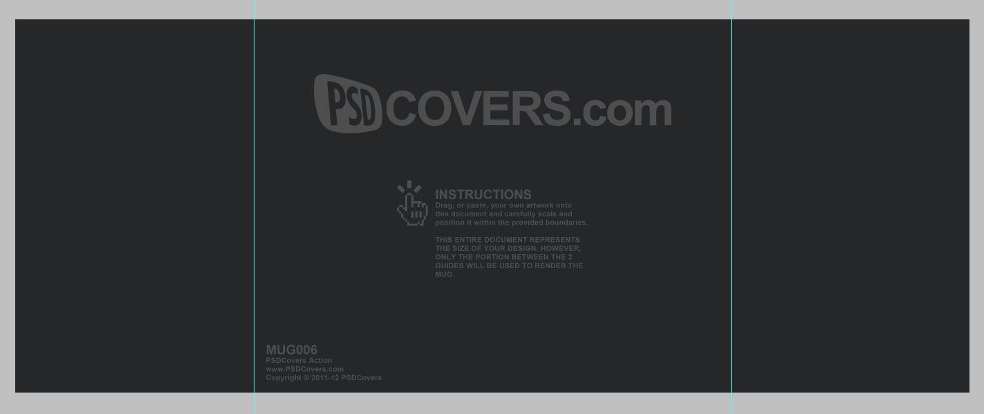

I have cs4. This is what I do using PSD Mug 006.
Open PS but do not open a new doc.
Click on Step 1 in the action list & run (triangle symbol)
[ATTACH=CONFIG]2894[/ATTACH]
This creates this blank template:
[ATTACH=CONFIG]2893[/ATTACH]

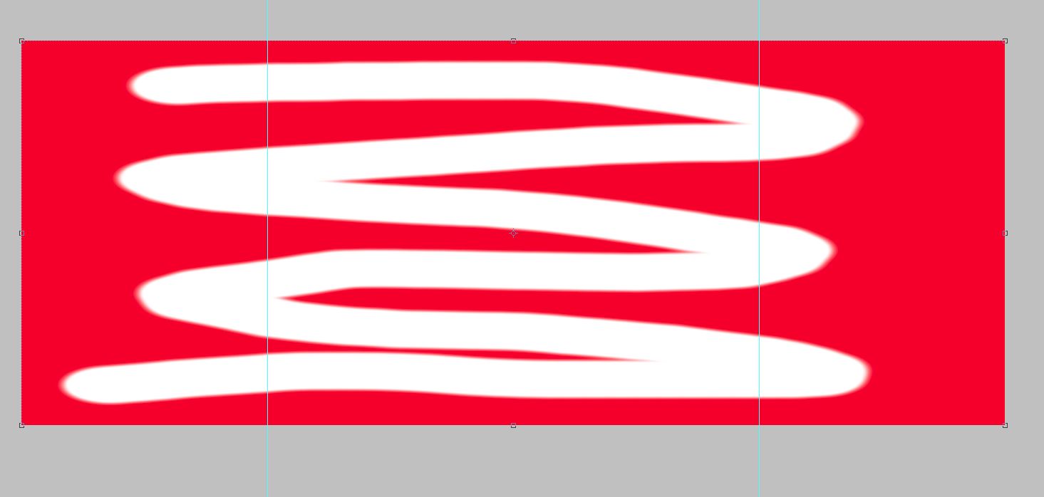

Open your mug picture in PS, select all, copy, then paste into the template doc (If I'm using Corel Draw I save file and open in PS)
adjust the imported pic to size to template.
[ATTACH=CONFIG]2891[/ATTACH]

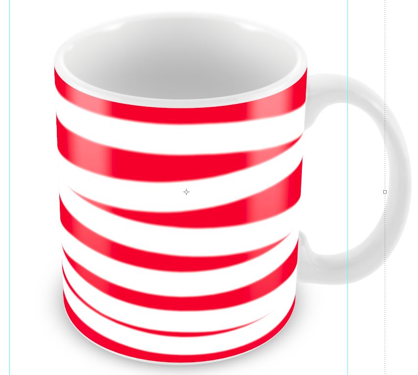

Click on Step 2 in the action list & run
And here's the finished mug:
[ATTACH=CONFIG]2892[/ATTACH]
Hope that helps,
Karen

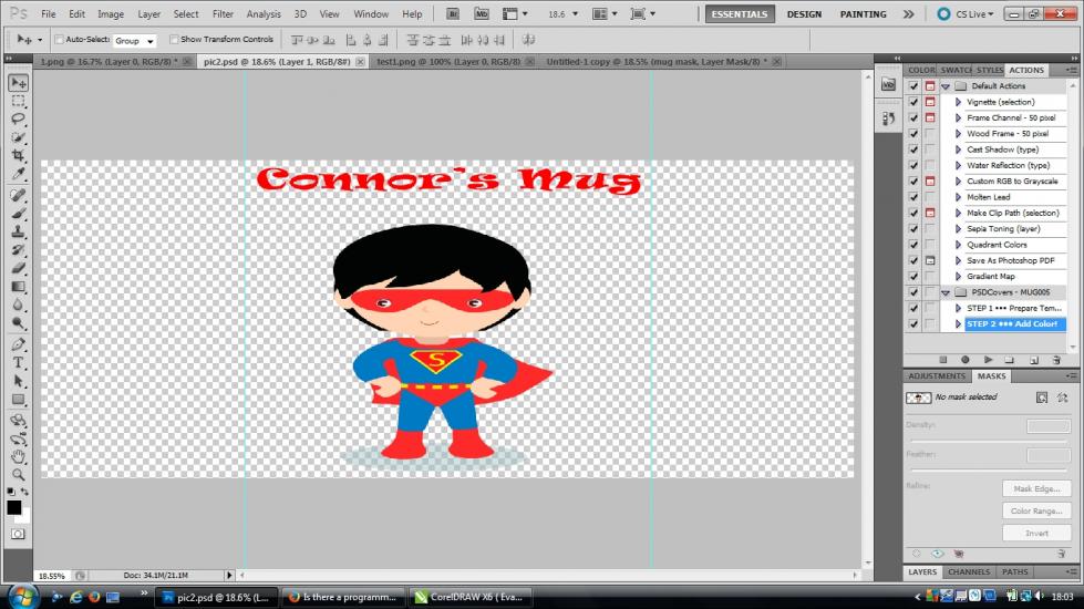

Hi Thanks Karen, Do you have to use solid colours for the whole design or photos? I tried to save some text and some clipart as a png so the white background was transparent as the mug is white and it goes wrong. See pics below
[ATTACH=CONFIG]2895[/ATTACH]
[ATTACH=CONFIG]2896[/ATTACH]

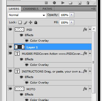

Re: Is there a programme that i can use to show what the mugs will look like before print
Hi Lianne,
I have always used a non-transparent png.
Just tried a transparent png - mug has a black background.
Do you have this black image after step 1? When I paste the png it sits on top of the black image, & therefore the black background shows through.
Just wondering if you are deleting any of the layers after step 1 so that the background looks white? Step 2 requires some of these original layers in order to render properly.
I would create a png with a white background. Just paste your png after step1. If you do it without touching the layers menu it should paste as the second layer down.
[ATTACH=CONFIG]2897[/ATTACH]
You can switch off the PSD layer (click in the eye) so that the PSD logo isn't rendered.
