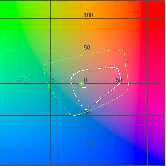

Paul;52258 wrote:i had a look on your profile and gamut is very low. so i dont think you can get many colors out of it any way.
fo example here is your gamut and my:
white border show amount of colors that can be produced by your icc. green shows what my icc can doo.
so...
in few words. i dont think your icc was created for your printer. it might be for another s22 but surely not for yours :eek:

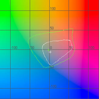

sorry to contaminate your tread but i found icc i created in the past for s22.
so this same printer two diferent profiles.
looks diferent?? :cool:
