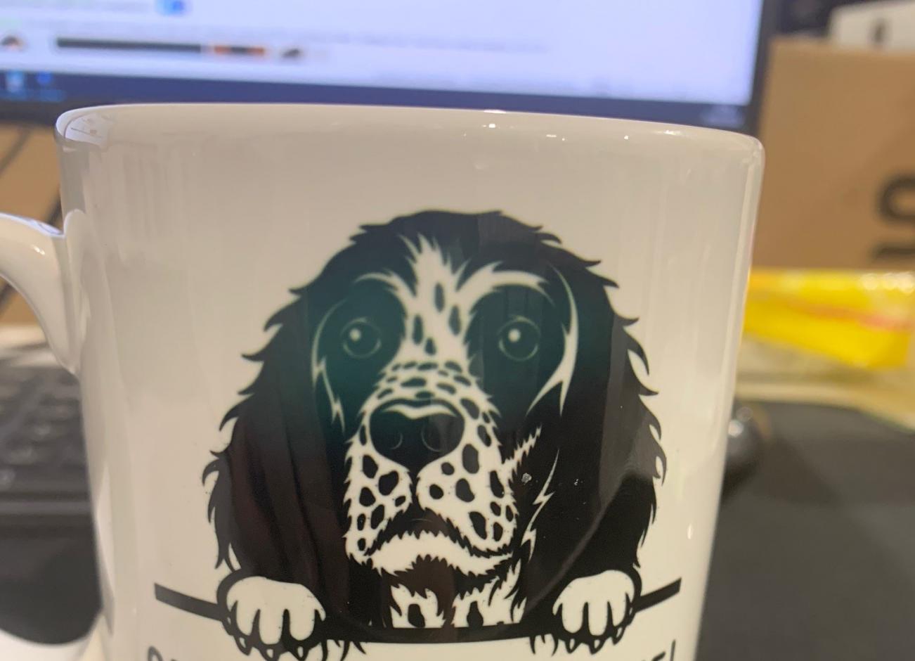

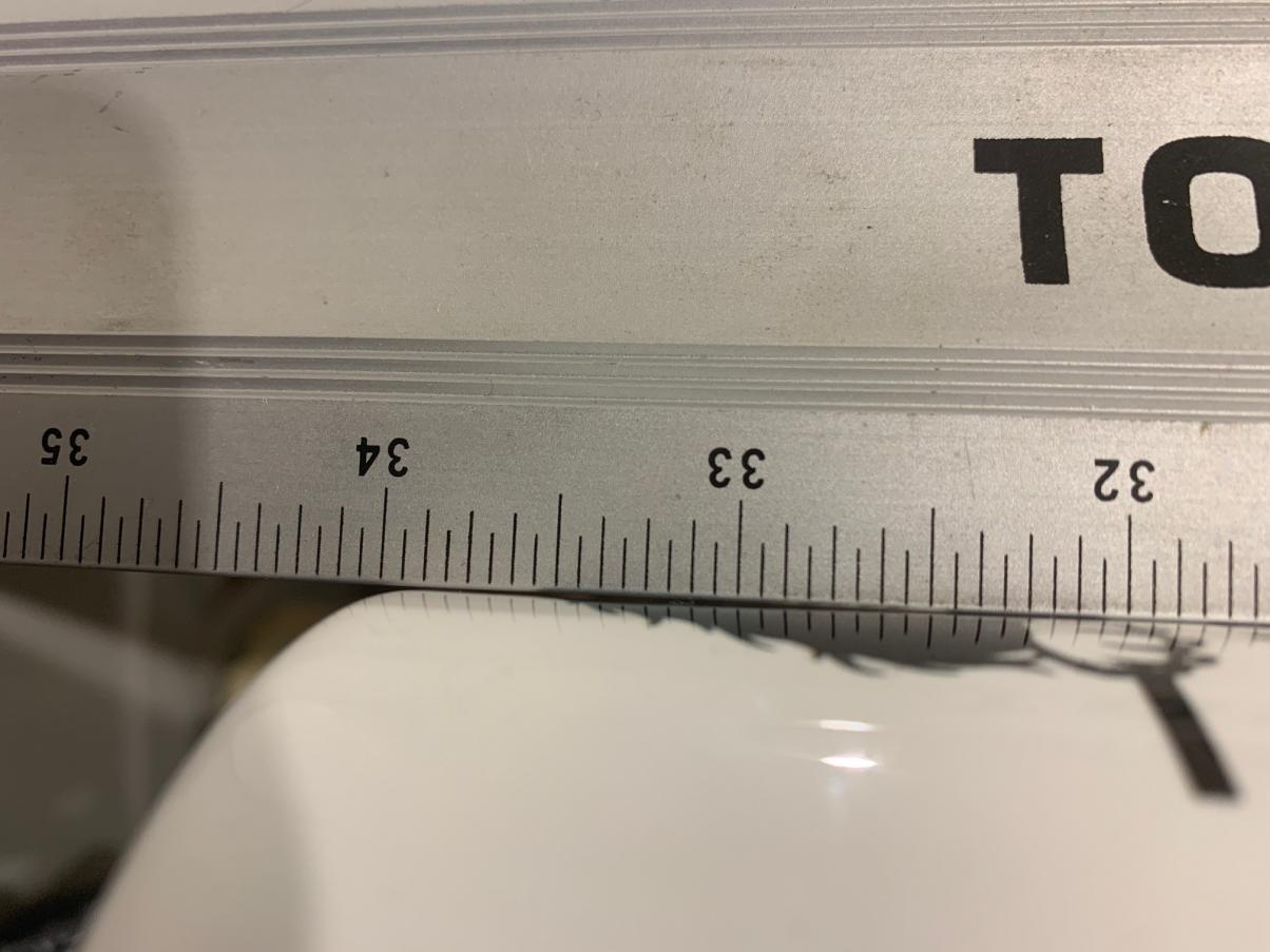

Another update...So I'm not convinced that printing 3up on A4 has really helped (although too early to tell really), however, we've had more bad mugs today, but now the blurring is not consistent and sometimes it's on the top of the mug, others at the bottom.
I have noticed that wherever there's blurring there's a slight dip/warp in the mug but I'm really suprised the silicone wraps can't cope with such small dips.
[ATTACH=CONFIG]6874[/ATTACH] [ATTACH=CONFIG]6875[/ATTACH]

Hmmm that is a small dip in my experience of dips. I feel your pain!

Wondering if thicker/tougher silicone wraps will help but sick of spending money now haha.JMugs;150385 wrote:Hmmm that is a small dip in my experience of dips. I feel your pain!
