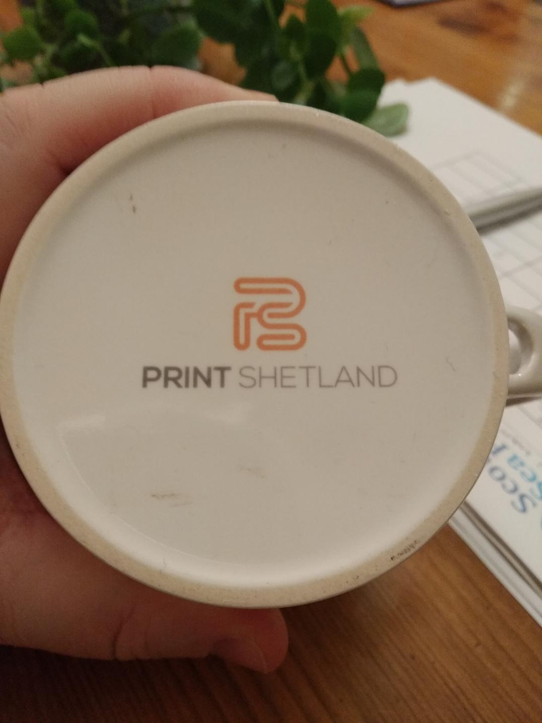

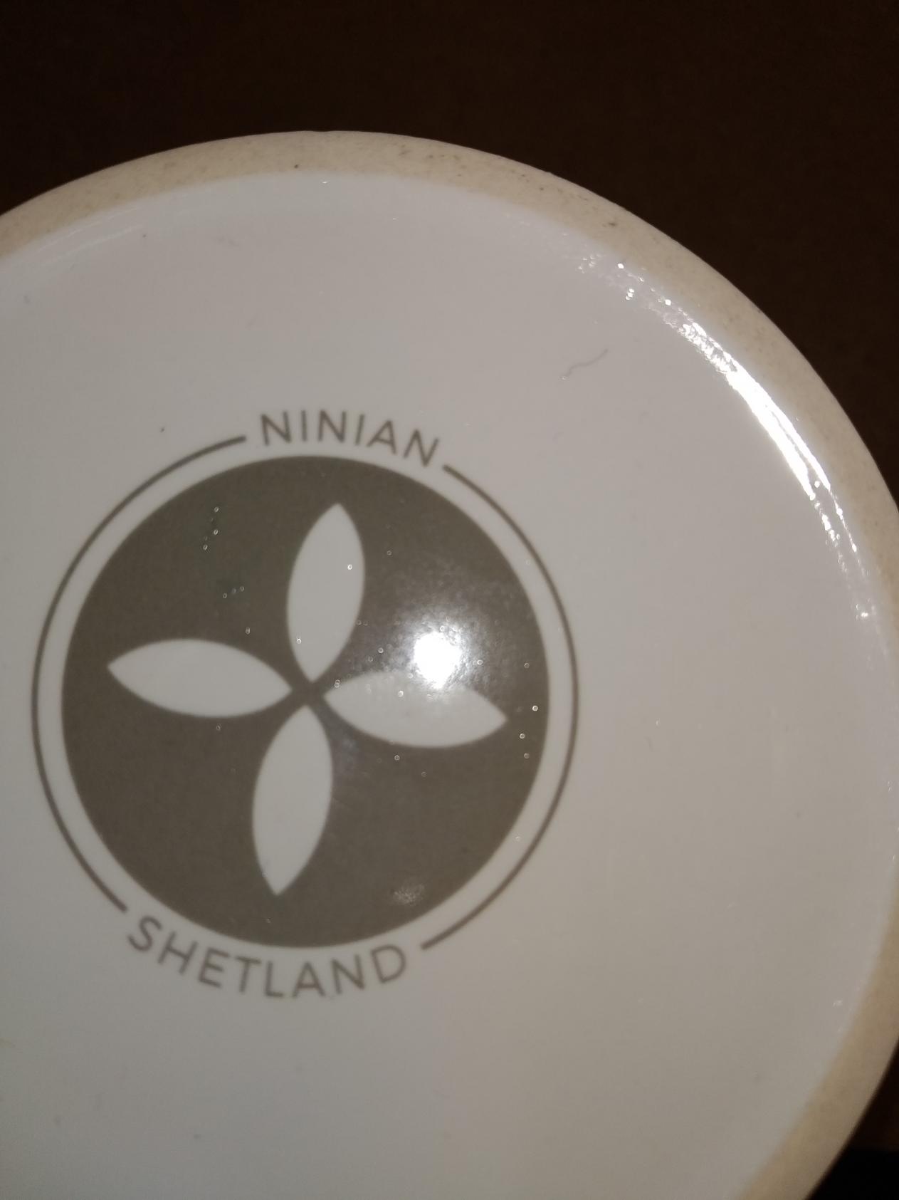

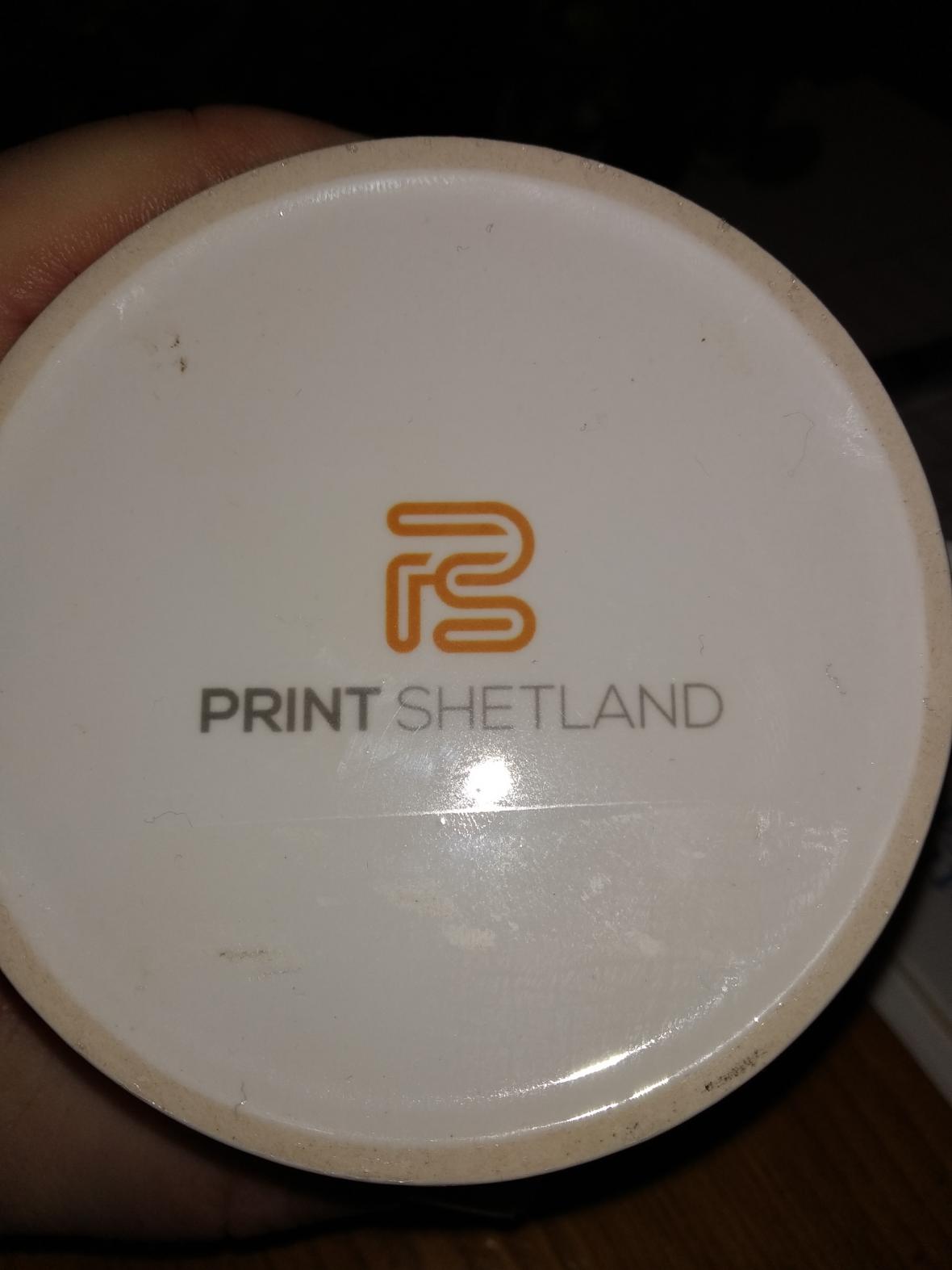

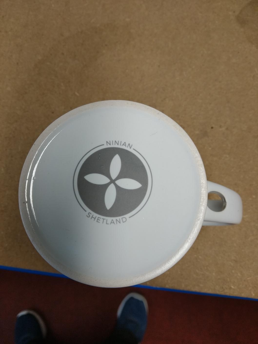

Had a few minutes tonight to run a couple more tests. Found a use for the uncoated mugs LW sent me! Coated a couple of bases and printed a customers grey logo along with one of my own orange/grey logos and very pleased with the results. Will add photo's.
Good coverage this time and no faded areas, these look better than in the photo's.
Re: Mug Bottom Heat Press
Apologies for reflection.

Wow! Those logos really raise the perceived value of the mugs. I like both, but particularly like the 'pop' of the orange. Well done Justin, definitely an experiment worth doing.
