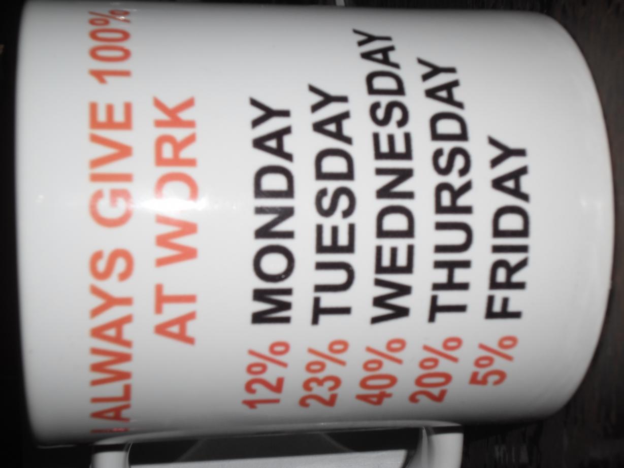

First off can I ask what software you are using?
For me, I downloaded both Photoshop and corel draw, and have found corel draw to be the better of the 2.
For corel I am using the SPR2400 enhMatte Bstphoto.icc while in my printer preference I am changing the "Select print quality" to quality priority.
I found that Selecting high quality caused an issue with ink smudges.
tonight its been perfected! 180c at 35 seconds and gained the result as pictured below. (I'm apologise for the image)
vB_ID:3880
vB_ID:3880
If this doesn't help let me know and I'll try help as much as possible, you are on the search google phase, while ripping your hair out :(
