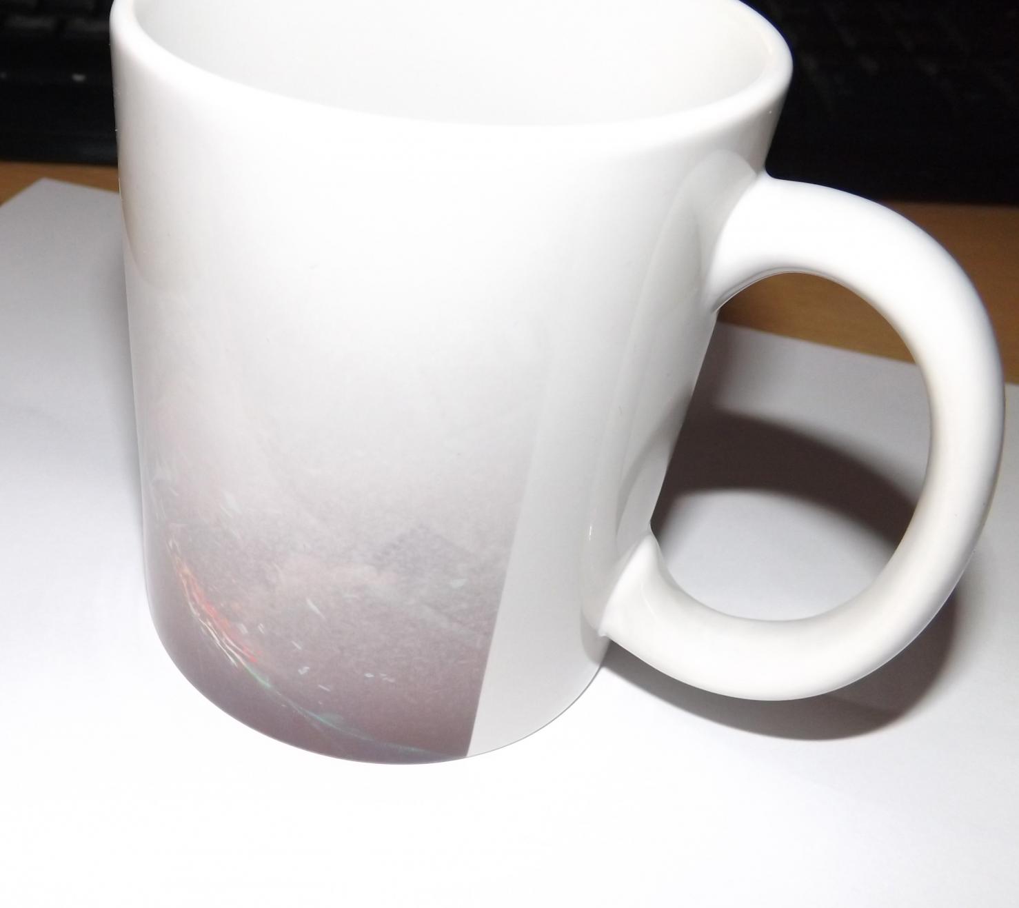

using the same settings as above - :frown: only diff was xpres paper instead of truipix...but that should not give that big of a print differancegalerion;88349 wrote:Taking my time down to 360 seconds fixed my black going brown issue, the mugs come out really hot if the paper touches them again then it will leave a mark. I'm using CG mugs heat is set to 190c, tru pix paper, 4 mugs in green silicone wraps. I hit preheat, once at 190c I put them in upside-down hit the preheat again to get temp back to 190c then hit the timer and turn the vacuum off. I have had this print all around the handle but did get a slight fade under the handle on one so i'm working on something to put some pressure there.
mugs were from BMS we had kicking about
and only ONE mug in the oven thing, not 4

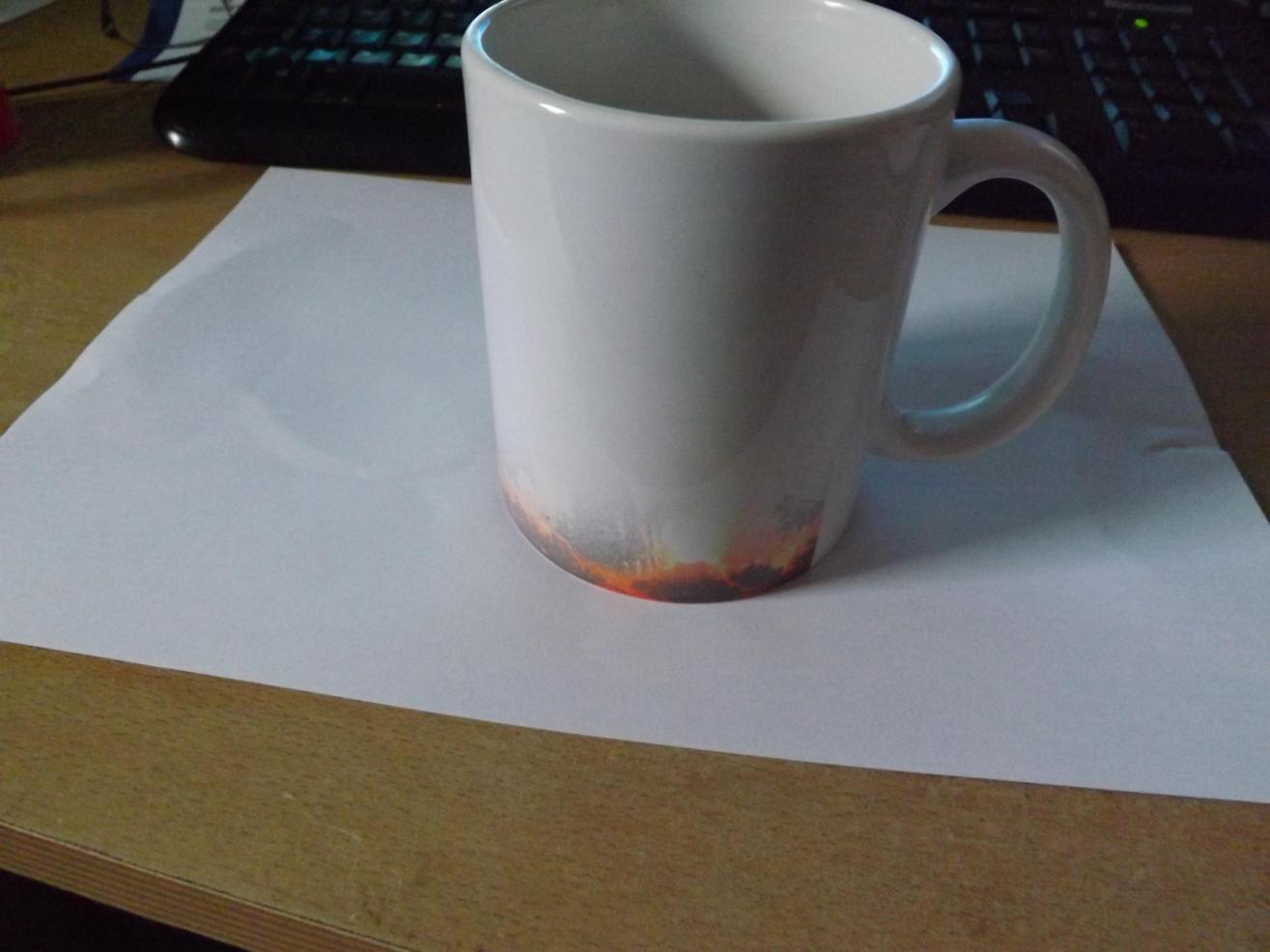

600 sec @ 190 and............
[ATTACH=CONFIG]2766[/ATTACH]
something def not right here :rolleyes:
off to cook for 800sec
EDIT - 900SEC SOD IT

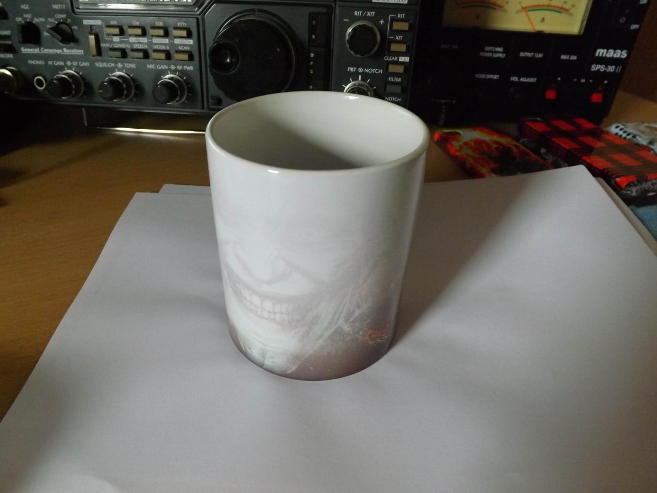

900 sec @ 190 -
[ATTACH=CONFIG]2767[/ATTACH]
WTH ??
pressed the temp button while it was cooking to see several times, was as low as 149
now, i got the other one set up for phone cases with the upper inside silver tray removed...
gonna try a mug in there till i see if there any differance

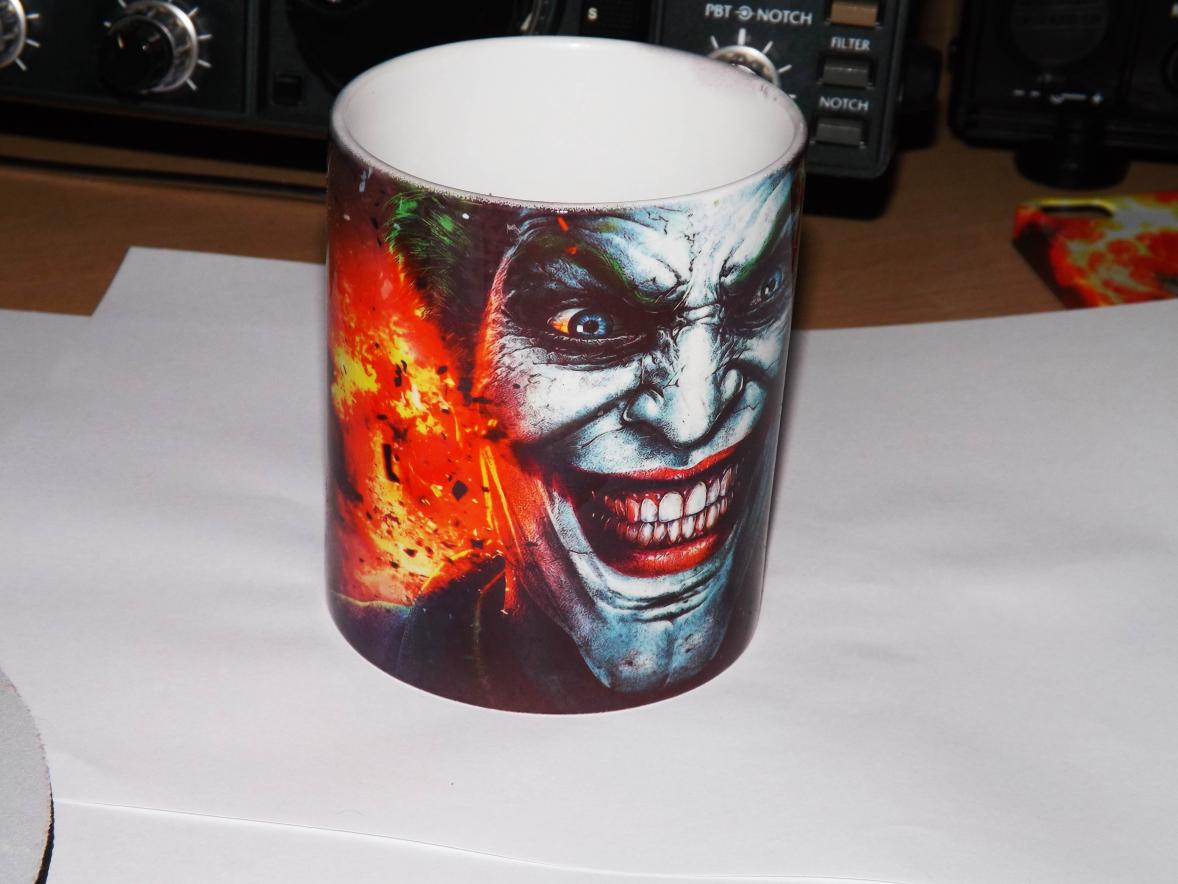

Re: mini 3d machine mugs
GOT IT :biggrin:
300sec @ 190
[ATTACH=CONFIG]2768[/ATTACH]
right now.....this is interesting indeed..
the other machine @ 900sec - when i hit the preheat button, NO FAN comes on, i dont mean the suction pump, i mean the fan...wonder if this has something to do with it guys ?
this mug above done on the phone case machine with the silver upper devider removed....oh, and i also shut the window...i have them next to the window to try and get some of the fumes out.
so, i think i might have a duff machine - BUT....off to try another mug and take out the upper silver devider on the other machine.....just to see if it is buggered or not :rolleyes:
