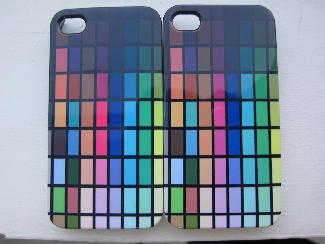

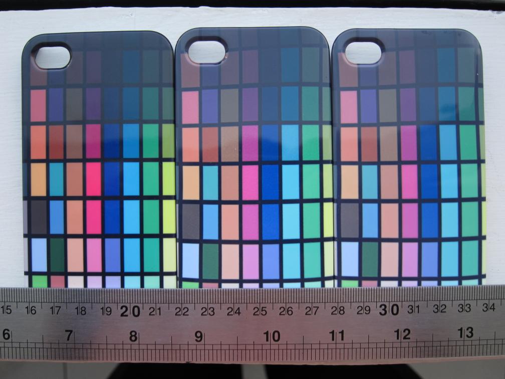

Here's the result of Case 1 and Case 2. With the leftmost case being a case pressed with paper and the old machine, then case 1 and rightmost is case 2.
[ATTACH=CONFIG]2728[/ATTACH]
At 190 C and those times, it's way over done. And the film wraps and stretches and creates the curved line...No good...
Here's the result for case 3, the right hand side case. Left hand side is the paper-pressed case.
[ATTACH=CONFIG]2729[/ATTACH]
The result is significantly better than the former cases although the color is noticeably brighter in the paper-pressed case...And I still have two issues:

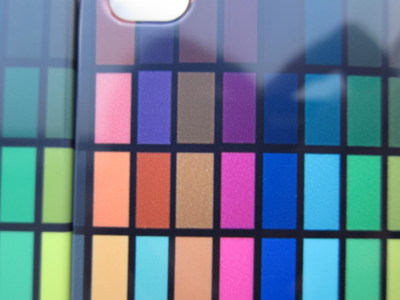

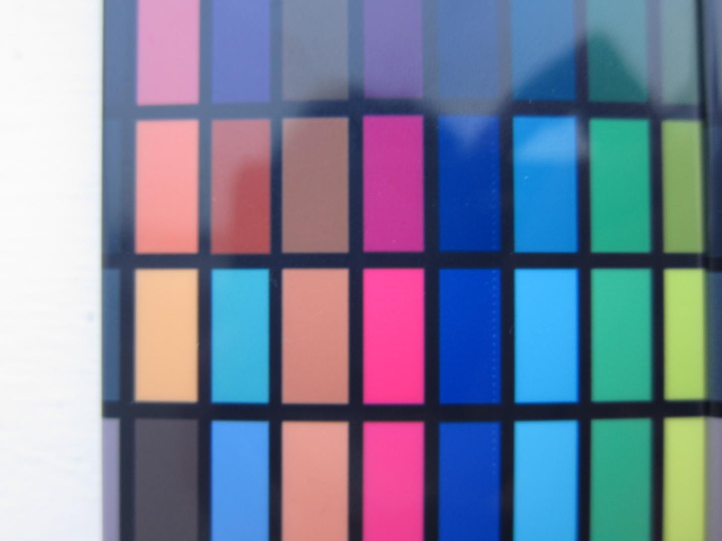

Grainy picture and rough borders (this is not the camera's graininess). Left picture is case 3 and the right picture is paper-pressed case:
[ATTACH=CONFIG]2730[/ATTACH][ATTACH=CONFIG]2731[/ATTACH]
In the old machine, it looks like the symptom of the paper shifting during press.

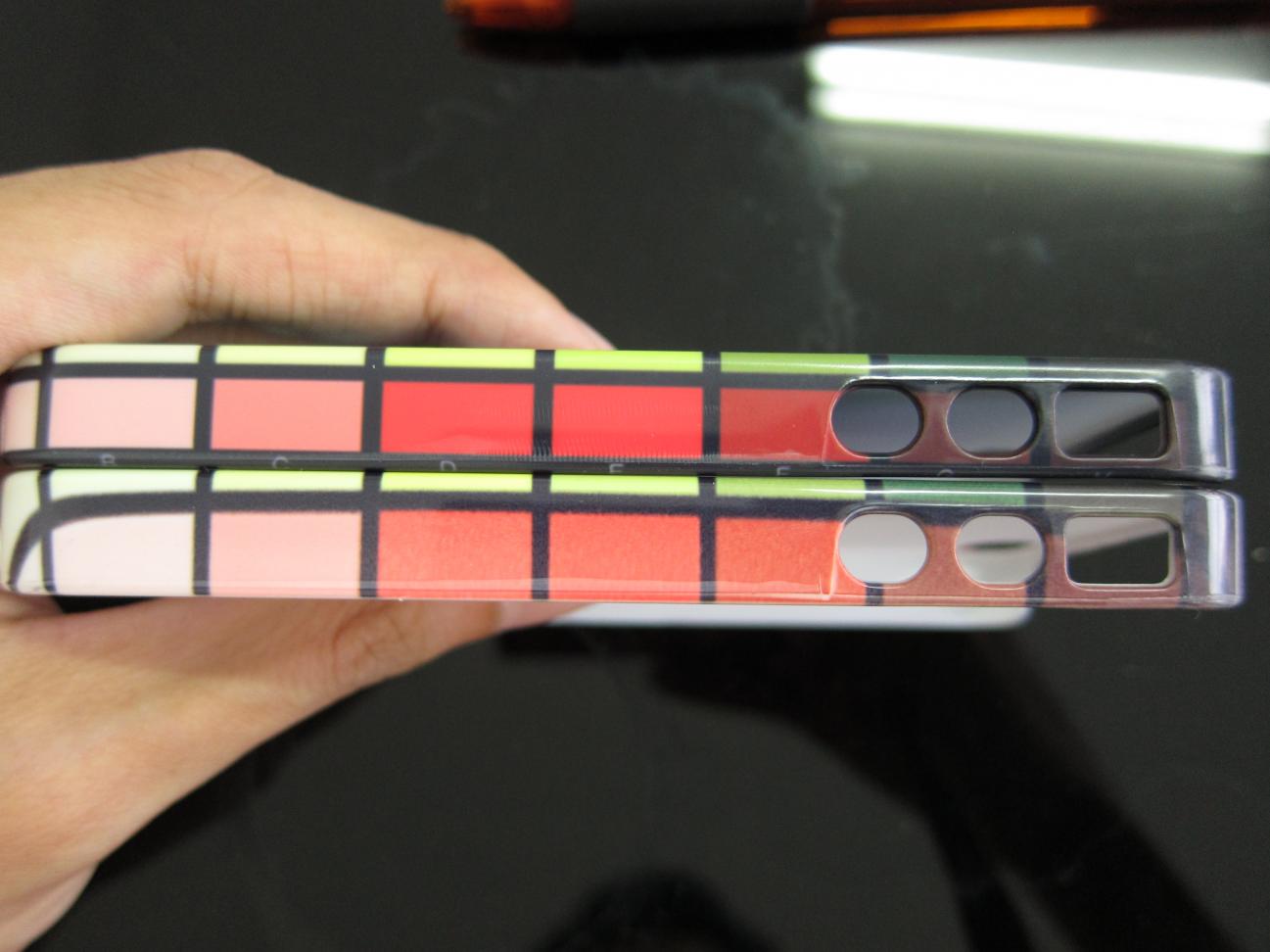

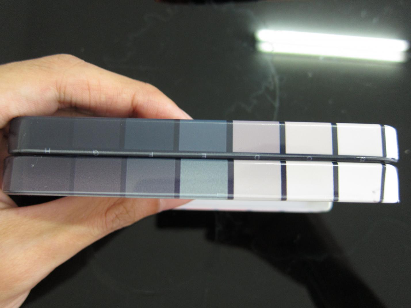

The other issue is the weak transfer on the side. You can probably tell which case is which judging from the corner and the color. The darker one is the paper-pressed case. And if you can zoom on the picture, it shows how the film-pressed is grainier and the border with the black line is fuzzier.
[ATTACH=CONFIG]2732[/ATTACH][ATTACH=CONFIG]2733[/ATTACH]
