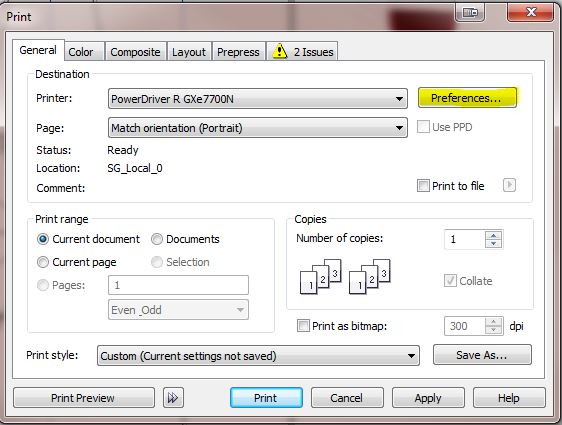

Been reading through this thread (just back from hols). Saw your screen shots on page 2. They looked ok.
However, when using the Powerdriver you need to be using the "printer preferences" option on the print page

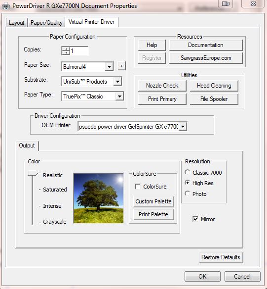

This will give you the Powerdriver's printing options - this is what controls the colour printing when using the Powerdriver as the printer driver. Choose paper type, substrate type etc., & the driver will select the ICC profile to use. Just make sure the option on the "Colour" tab are set to Printer controls colour as you had in your earlier screen shots.

Yeah all that is setup correct I just forgot to add screen shot
I've stuck with the icc instead of powerdriver I'm getting better results also I've tested a few mugs and they print perfect which means it must be the metal inserts I use for cases

Hi Matthew, I am glad we were able to resolve your problem , it just goes to show that the quality of the products that you are using can effect the quality of the print. If you have any future issues then please do not hesitate to contact us. Best regards, Kris
