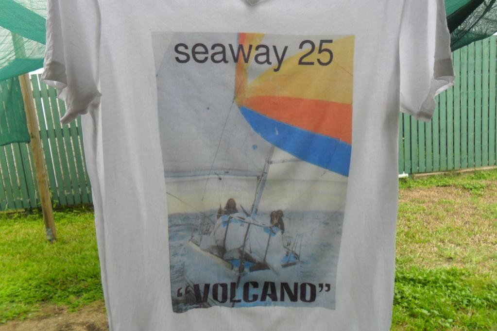

Ok, this is the latest sub on cotton. I narrowed it down to four products I had used with some success, three of which worked fairly well but I cannot remember what I used to activate one of them. Out of the other two, one seems to be pretty well bullet proof, and I'm concentrating most of my wash and wear tests on that. The problem is that supply of that product is patchy at best.
I tried a number of so called 'picture varnishes' that are supposed to be clear, but they leave a yellowish border, even the ones that say 'non yellowing'.
I have been testing another more commonly available product that, as you can see in this pic of my latest shirt, does now have a yellow overspray.
This product works the same way as the one I had best results with, but I don;t think it holds the dye as well, although a shirt done with a quick application of this stuff seems to be reasonable after a few washes in very, very hot water with Dynamo detergent.
I'll treat this one with a bit more respect because I rather like the way it turned out.
As always, there are no ICC profiles used, so people's skin might look a bit odd. The pic is cropped out of a larger image so resolution is not great.
And of course, it IS cotton, so you don;t get the lovely vibrant colours of polyester.
[ATTACH=CONFIG]2383[/ATTACH]

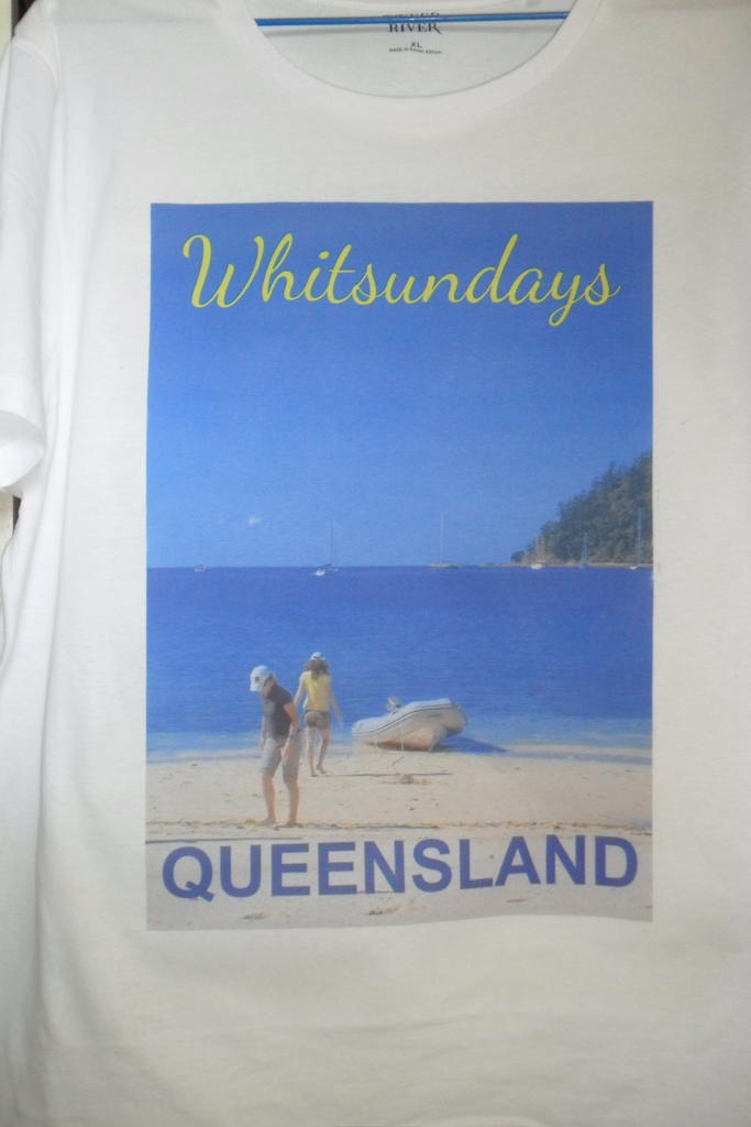

Here's the 'old poster' shirt after a few more washes. This is done with the product I think I will stick with. Still waiting on approval to buy in bulk, which will make it not much dearer to print than JetPro. I should add that it is wet in this pic. It gets light and covered by a soft down when dry.
Wet, it shows that the colours are not washing out or fading. Dry it looks 'distressed'.
[ATTACH=CONFIG]2384[/ATTACH]
