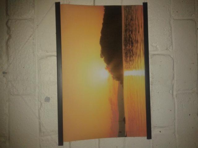

rossdv8
Posts: 295
Joined: 22 Apr 2013, 23:27
Re: My First Canvas - is it ok ?
Post by rossdv8 »
That's a pity Nik. I use one of my Epson A3 printers to make these on A3 canvas sheets. I started by cutting a piece out of a cheap 'dollar shop' stretched canvas. But I had a similar result to what you got from the Ricoh about 3 times out of 5.
Then I found pads of A3 and A4 canvas sheets. Works out about $8 for 10 pages of canvas.
I tried all ways to frame the things cheaply, then found some poster strips like we had in the 70's. Only trouble is they curl a bit at the sides when the humidity is over 90%, but they flatten again when it is normal.
As you know, most of my sublimation and other stuff is done with photos I have taken from my boat, like this sunrise. It is a little piece from the centre of a photo, blown up just for the colours.
I had one sublimated on poly treated canvas, but someone wanted it for an office because it was really bright.
You might find the canvas pages from 'pads' or packaged feed through the Ricoh, as they do in the Epson. It was just because they were so thin, the ones I cut our screwed up a bit.[ATTACH=CONFIG]2580[/ATTACH]
Cheers

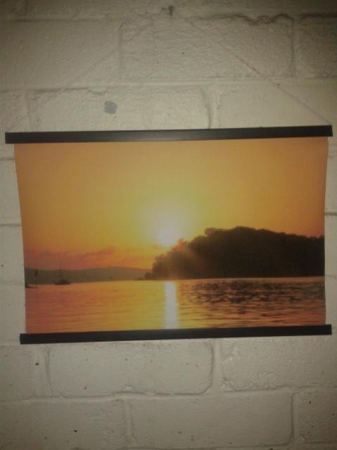

rossdv8
Posts: 295
Post by rossdv8 »
That's a pity Nik. I use one of my Brother A3 printers to make these on A3 canvas sheets. I started by cutting a piece out of a cheap 'dollar shop' stretched canvas. But I had a similar result to what you got from the Ricoh about 3 times out of 5.
[ATTACH=CONFIG]2581[/ATTACH]
Printing inkjet onto canvas was what I was doing before I got caught in all this sublimation stuff.
It is quick, easy and costs about $2 to make an A3 print, plus $1.50 for the plastic strips and they sell for $20 each.
Cheers
RossD

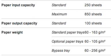

spongerobinson
Posts: 470
Joined: 21 Feb 2013, 22:32
Post by spongerobinson »
Nik,
According to the Ricoh website, the SG3110dn can accept the following paper thicknesses:
[ATTACH=CONFIG]2582[/ATTACH]
The link you posted is for 270gsm canvas, so I wonder is it too thick for the printer to print onto?
Might be worth trying thinner canvas sheets?

rossdv8
Posts: 295
Post by rossdv8 »
Oops. I wrote Epson when I meant Brother Printers. (Fixed it)
Nik, The Brother should only take fairly light paper, but for feeding 270GSM canvas you do two things.
Never feed from the paper tray, use the manual feed slot.
Tell the printer you are printing on card or envelope.
Since I learned that I've had no problems with the Brother printing on canvas for years, other than ink problems. The Brother uses dye inks and the Epsons use pigment inks. I run Epson pigment inks in the Brothers because I found the Brother ink wasn;t good with JetPro paper.
If the Ricoh has a straight through manual feed, you should be fine. (Maybe)
Cheers,
