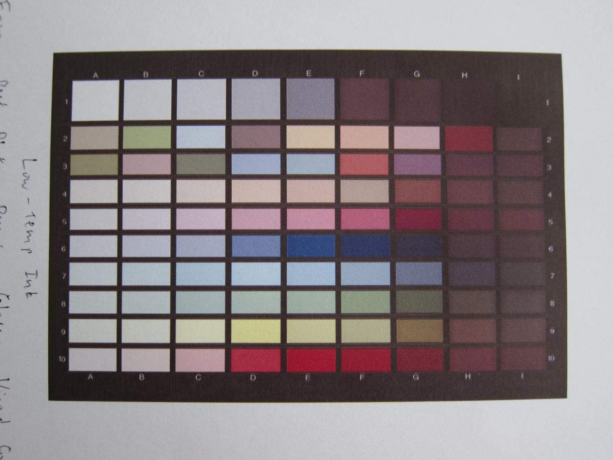

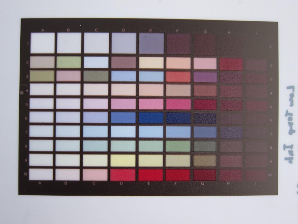

Hi all,
I just purchased the new mini 3d sublimation machine, along with the accompanying low temperature sublimation ink and film. The reason I'm buying this machine is because it can press phone cases with film! And that's what I need!
Here's my setup:
Film: Korean transparent film in A5 size
Printer: Epson T60
Ink: Supplied low temperature ink
Press: New mini sublimation press
My problem is that the printing quality on film itself is grainy for certain colors and not sharp for the edges. Printing is absolutely fantastic on regular sublimation paper so I suspect it's the film...
I've attached pictures:
[ATTACH=CONFIG]2837[/ATTACH] The above setup on film (you need to zoom to see the visual artifacts)
[ATTACH=CONFIG]2838[/ATTACH] The above setup on sublimation paper
This problem directly affects the pressed case at the end.
For those of you who are experienced with the film, I really need your help! What is causing these artifacts on the film? And what can I do to counter it?
Any advice or comment is highly appreciated!
Thanks!
Jeremy
P.S. I tried with regular sublimation ink and the print result is even worse...
