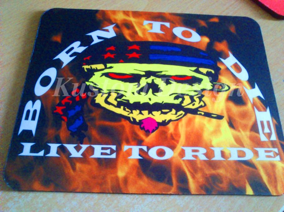

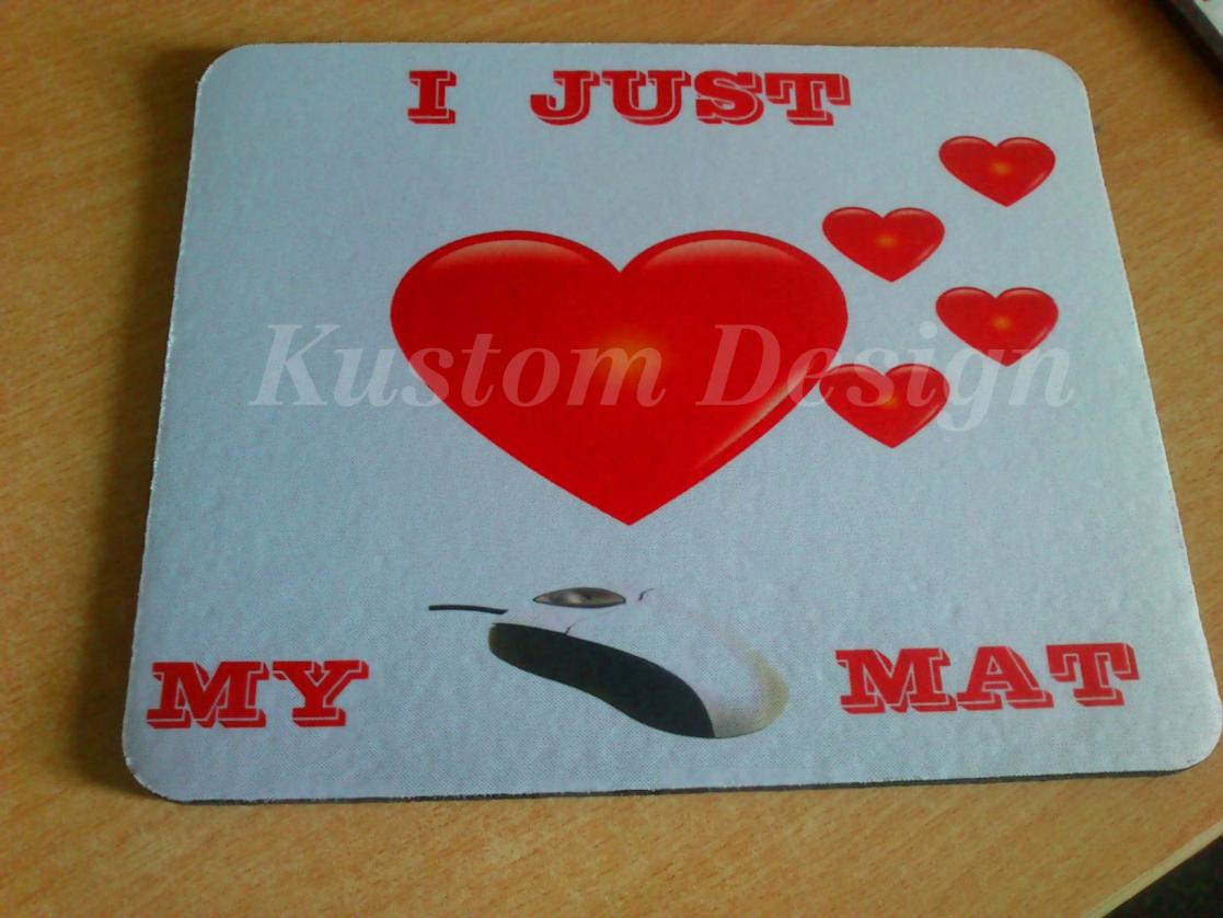

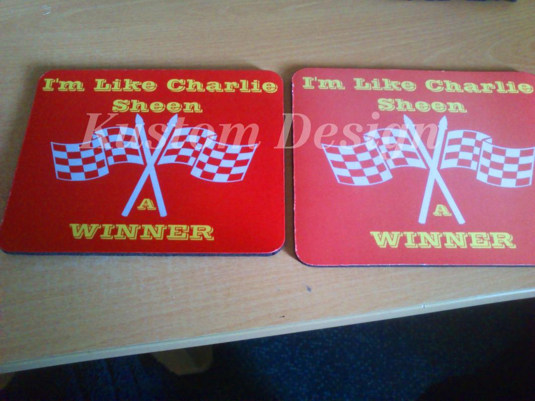

Right another go with the dreaded mouse mats....WOW, what a differance !
upped the time to 120sec ( double recommended time ) - YES !...colours coming out same as the screen !
Noticable differance between the charlie sheen ones - pink vs red
So jonathan ( JSR ) think i,m on the same boat as you bud lol
[ATTACH=CONFIG]1003[/ATTACH][ATTACH=CONFIG]1004[/ATTACH][ATTACH=CONFIG]1005[/ATTACH]
finally....a result !.....:biggrin:
The writing on the sheen one aint blurred, just the camera angle....its fine in real life !
EDIT - cant upload any bigger than 2mp to this forum...hence the not so good pics !...or am i missing something in the settings on here ????

Is your screen capibrated buddy? It would help you jude the colors i right or not.
Re: My very first Sublimation Print
As best i can without any machines paul....then yes !Paul;45599 wrote:Is your screen capibrated buddy? It would help you jude the colors i right or not.
If you made your word slighter smaller, and slightly increased the size of template bigger, so the the background colour is bigger than the mouse mat it will go right to the edge and leave a even colour straight down the edge of the mouse mat, leave enough so when you fold over the paper the background colour is over the back, hope that makes sense, if not ask me to explain again I won't mind
hi jenny.....regarding the "i luv mouse mat" - i know i got the layout/wording size bit wrong at bottom.....has been rectified now for future ones....
i take it thats what you were referring to ?
