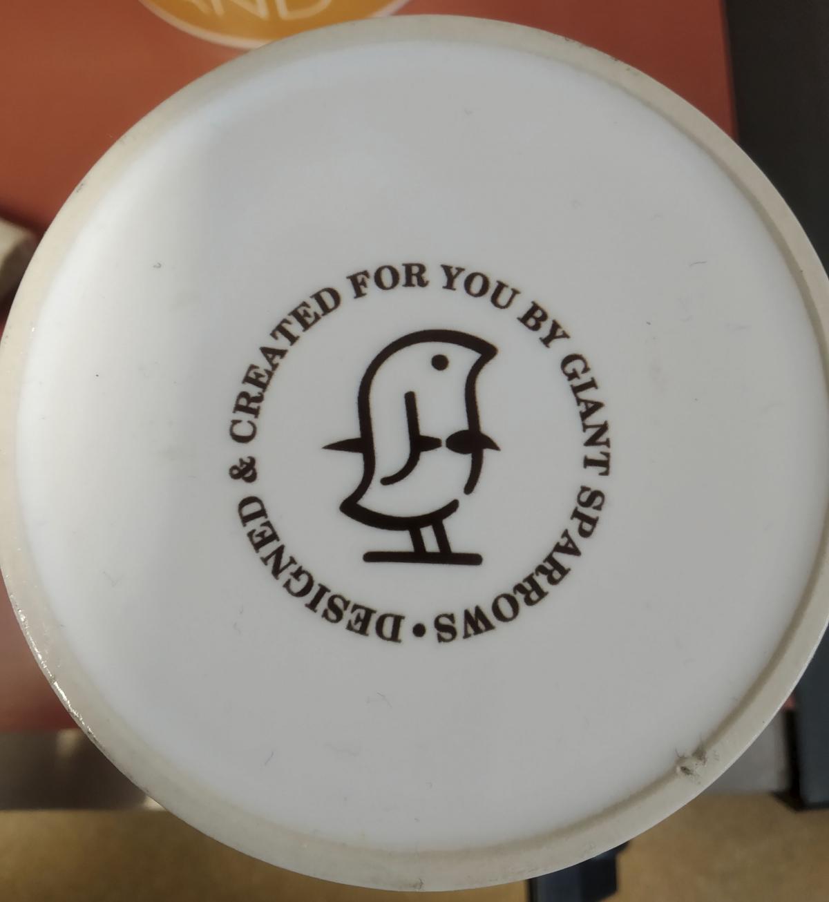

Just printed this logo onto XP5013 & Listawood mugs, this is photo of the XP5013 which printed slightly better.

Wow that's perfect. What was your set-up, did you press before or after doing the regular pressing around the mug and how much extra time did it take? Infoooooo please.

Re: Mug Bottom Heat Press
It's good but not printed perfectly at the top, slightly faded, doesn't show on photo too badly though.
Just using test mugs at the moment (rejects!) Pre-treated with Subli Prep, left for 10 mins, cured in oven for 20 mins at 160c. Left overnight to ensure cool etc. Printed in my flat press (wind very high!) for 4 minutes with a 5mm rubber pad on top to allow for the curve on the base.
Paper I used was cheap stuff, Trupix can stick it appears but I will be testing again.
Spray goes everywhere when applying so I cut a circle out of a small box and popped the mug in so spray only goes onto the bottom. Not very technical but does the job for now.
You should be able to cure the spray at the same time as applying the main image. As mentioned on other thread about mug oven timings, I reduced to 160c and cooked a mug for 20 minutes and it was perfect.

Blimey, amazing it works but wow so much prep time although it probably is the same for pad printing which would need cooking as well.

Yeah, bit of a faff. You could get setup better and reduce the time. I think getting an even coat of spray is the hardest thing, I expected that. I've got slightly uneven coating so the top of my logo isn't quite as clear. That said, I'm pretty chuffed at the difference from previous prints.
I should do full colour next
That's where it will stand apart from pad printing.
