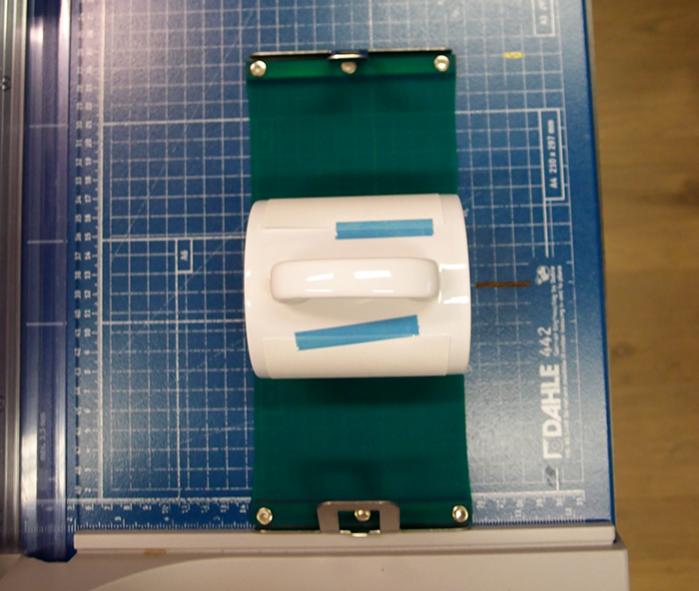

For the fastest wrapping, line your clamp up to the edge of your trimmer if possible. Mark the centre of the wrap with a marker to make a guide..see image. Line up mug handle with red marker. Perfectly centred wrap!

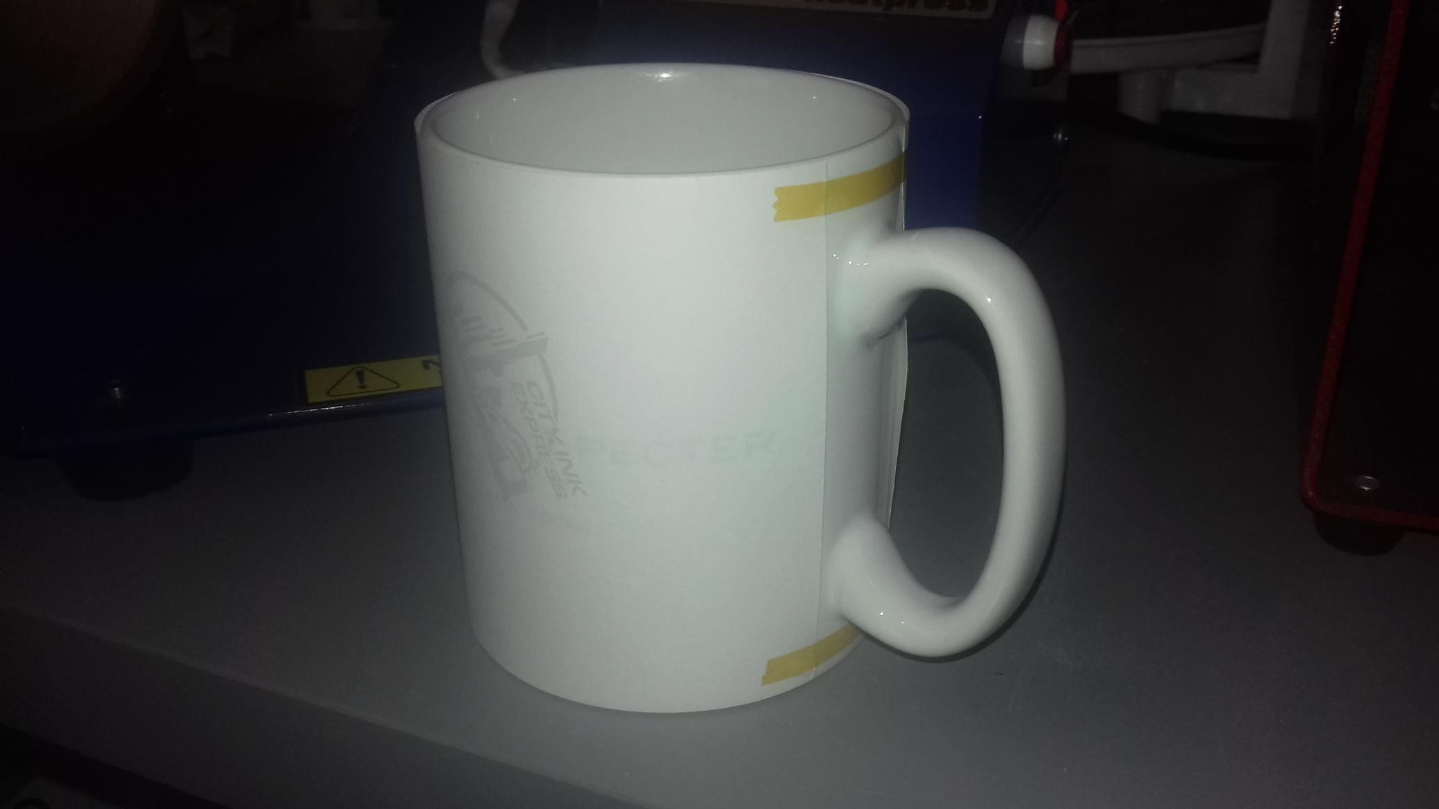

I wrap mine the full height of the mug and virtually touching the handle.

I liked your mug wrapping method [MENTION=7061]webtrekker[/MENTION] in a previous post, so that's my next upgrade. I use the width of an A4 page normally.
