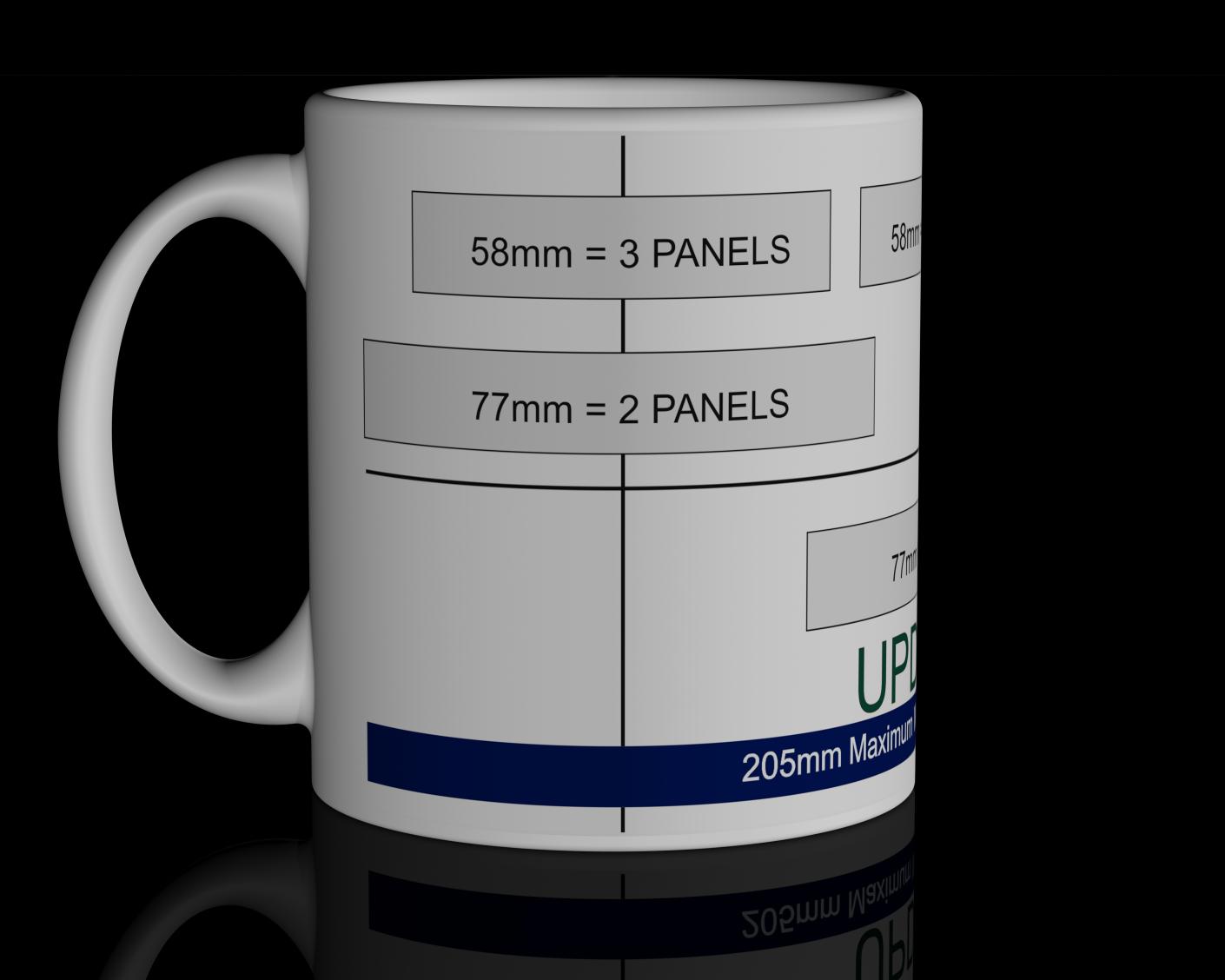

I've been looking for this for some time. Tried the Photoshop system but did not get on with the one I tried, possibly my lack of Photoshop knowledge.
My solution was to use 3DStudio Max to create the 3D mug, then render views (front, back, mid) and the results are acceptable.
It would be an expensive solution if you have to buy the 3ds Max software.
The Techcurl one looks really good, but it is very low resolution.
Pic of mug below created in 3ds Max.

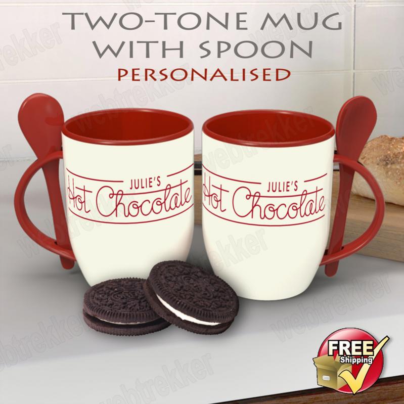

I often render mugs in Keyshot 4 for my own purposes. Using a 3D model and rendering software gives you great control over many factors such as position, lighting, reflections, backgrounds etc. Also, if you're capable of designing your own 3D models, then there's nothing you can't create a mockup of.
For instance, I designed a model of the two-tone 12oz mug with spoon when no alternative mockup generators were available. I also designed a 10oz Durham mug, as sold by Listawood, which has a flatter handle than the 'C' type you find on most 3D mug models on the net.

Another alternative is to model the mugs yourself, render them with a grid on in place of the wrap, then make up a Photoshop document and Warp an image to fit the grid. Save the layer as a 'Smart Object' then all you have to do in future is design your wrap image, load it into the Smart Object layer and you have an instant rendering!
In my own example, I've thrown in a couple of Oreo's free gratis, and a backdrop!
These are things you can easily add in Photoshop ...
[Mug model designed in Rhino5 from pictures I took of an actual mug and spoon. Originally rendered in Keyshot 4.]
