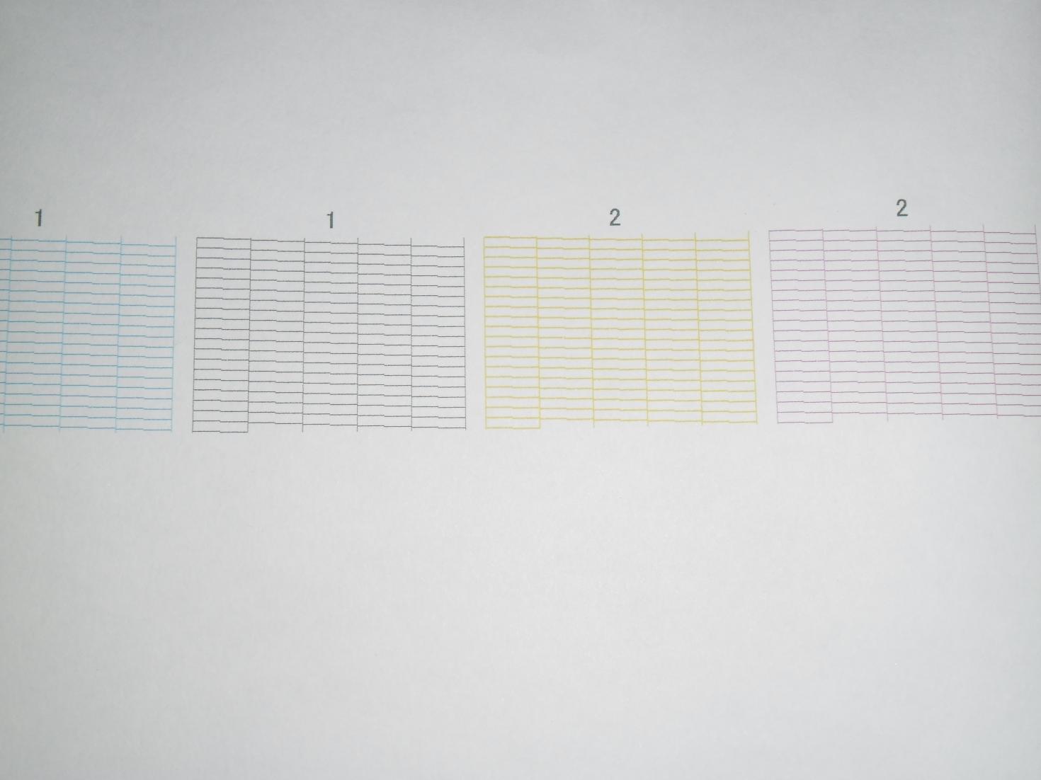

You could get an ICC profile made to correct colours for that printer, assuming that the ink you have is actually suitable for the Ricoh printers, and is sublimation ink. You also want to make sure you have decent sublimation papers.
From looking at your pictures though, this looks to be more of a problem than just needing an ICC profile - from my guess either the ink isn't good, or isn't flowing through your printer properly - can you post a picture of a nozzle check pattern.

I got it to work!!!!!!!!!!!
That has been the biggest pain in my ... well! anyway.
Ricoh SG2100n
After installing your sublimation ink and printing (ensuring you have the right side of the paper) if you get the same as the images above I have posted, try adding the cup to the press for 30 to 35 seconds.
So you want to:
Put your dummy cup in the press and turn it on.
Allow it to heat to 190 c
Get your design and tape it to your cup ensuring the cup is clean.
Wait for the press to heat then put the cup you want to sublimate in.
Wait for the temp to rise back to 190c
Start timing for 30 - 35 seconds
Remove cup from the press and get the paper off.
place slowly into room temperature water, leaving it to cool
If you cup is faded add more pressure.
