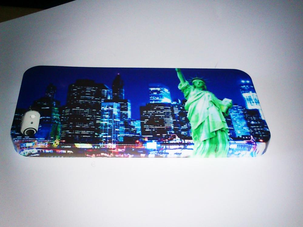

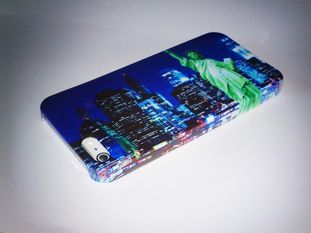

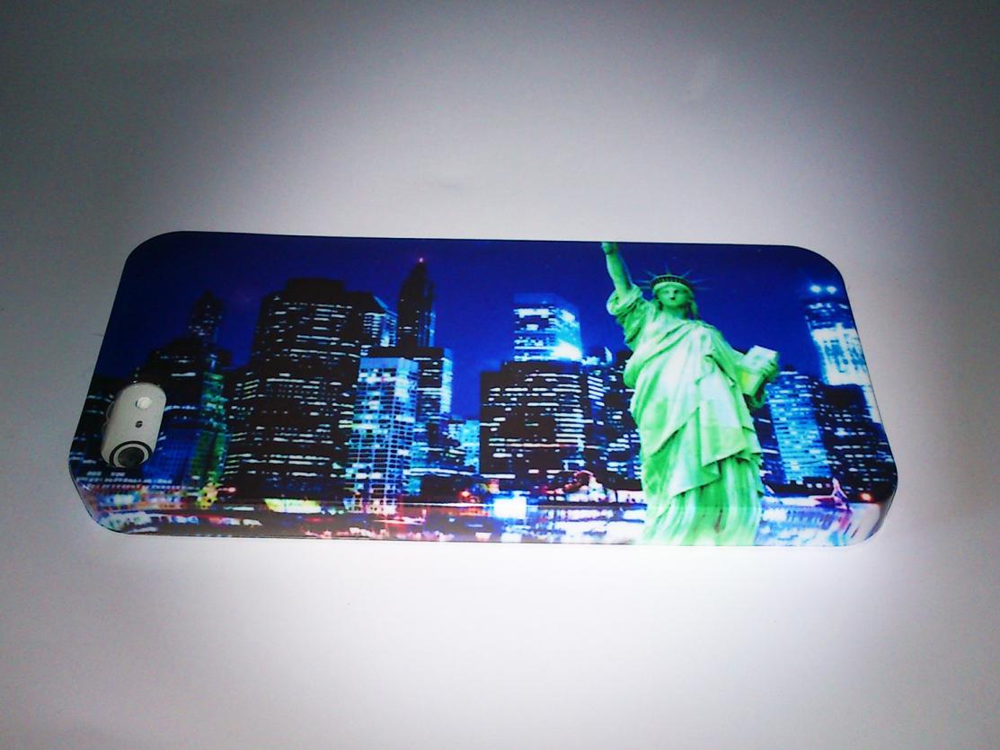

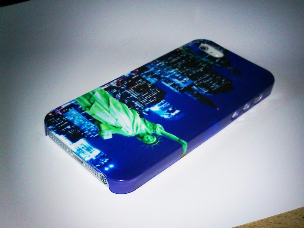

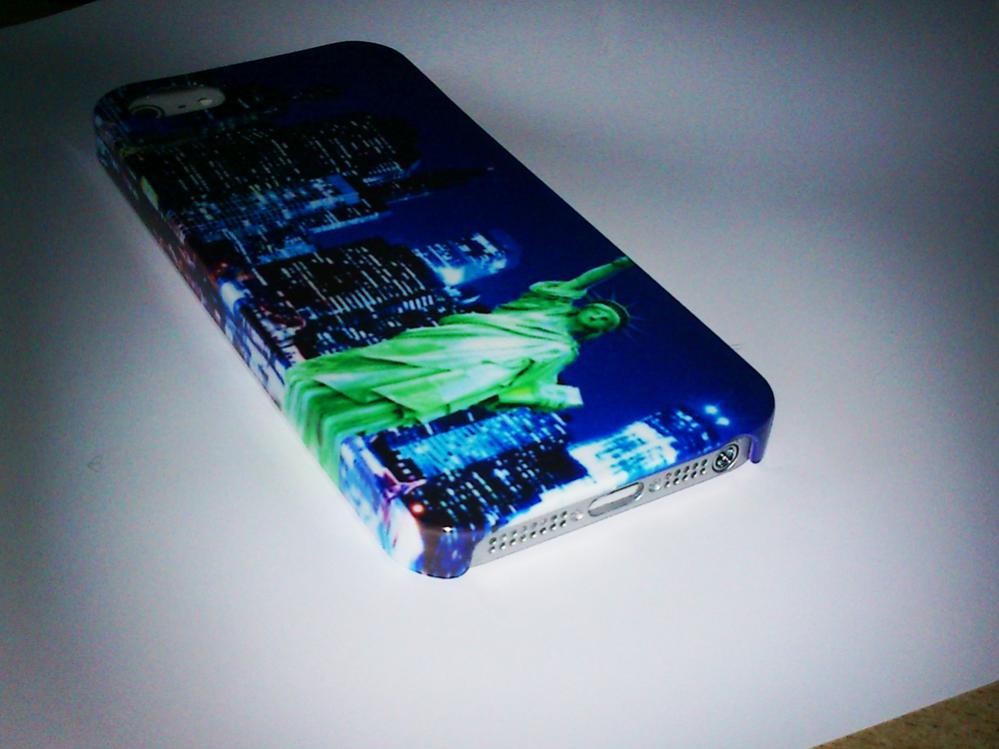

some more 3d film samples - getting there
[ATTACH=CONFIG]2723[/ATTACH][ATTACH=CONFIG]2724[/ATTACH][ATTACH=CONFIG]2725[/ATTACH][ATTACH=CONFIG]2726[/ATTACH][ATTACH=CONFIG]2727[/ATTACH]
finding the high heat 190c with the paper is warping the cases some.....the film @ 160c come out nice n soft...bit of ply in them....into water...
perfect fit :biggrin:

They're looking good I think i'd be happy with those corners.

Looking good although there seems to be some smudging on pic 5 maybe?
Interesting that you're using 160c, I only do mine at 120c. How long did these cook for? Are you using vacuum delay? What film?

Justin;87761 wrote:Looking good although there seems to be some smudging on pic 5 maybe?
it this crappy camera phone justin...its pants.....
using the Korean transparent film - time 300sec - temp - 160c - vacuum kicks in after 20secs delay ( 280secs )
