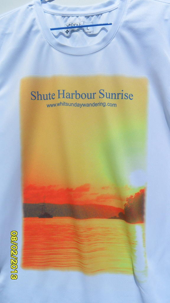

rossdv8;81549 wrote:If I printed it on polyester canvas it would get a bit of artificial 'pop'.
But sublimating onto actual polyester doesn't give you an artificial pop - it is just showing you the full colour and contrast that fully and properly sublimated inks can achieve, rather than the farily washed out colours you are currently getting. I think this then goes back to you not using an ICC aware process. In our work, we create the ICC profile from scanning the colour charts from polyester fabric or a white coated aluminium sheet, so the colours we're expecting and see on screen are very close to what our final products are once printed - sublimating it doesn't add anything we're not expecting, and doesn't add anything 'artificial' - if we want a washed out pastel tone, that's how we colour it in photoshop, or if we want a really vibrant and saturated red, like a London bus, phone box, or postbox, then again that is what we get.
From looking at your pictures, you are achieving the same sort of look as a 50% polyester/50% cotton fabric, which I suppose in essence is what you're creating by coating the cotton fibres in a polymer based liquid/resin/carrier of some kind.
rossdv8
Posts: 295
Joined: 22 Apr 2013, 23:27
Re: Looks like we will be giving up press on heat transfers altogether
Post by rossdv8 »
Oh my dear lad, I can assure you that polyester can very easily give an immense 'artificial pop' to almost any image. Polyester is by definition artificial.
Sadly, looking at the pictures is a poor way to judge. You should see some of the truly awful stuff posted here by long term members using the best equipment. Mugs with horrible washed out colours and various items with burnt browns where something should be black. I would wager that some of those people have the original sitting there looking perfect, and wondering why on earth it just doesn't look right in any of the dozen pictures they took of it.
I've only seen a few photos posted here where someone has taken the time to set up a lighting booth.
It doesn't matter what I do to cotton, the only way to make it bright and shiny like polyester is to put a polyester coating 'over it' and print on that. Others have already done that, with varying success.
I am NOT sublimating a polyester shirt. It will NOT have the same look as a polyester shirt.
My market is in the tropics, in a tourist area. It has to be tough enough to stand up to commercial laundromats, and to be worn day in, day out. It also has to add no more than a minute to the time, and no more than $1 to the materials cost.
I don;t always do dark and gloomy sunsets! The stuff I post on here is usually just stuff I'm playing with.
This was also without any ICC profile, and also printed from Linux or from the Android tablet - I can't remember which, to one of my Brother printers.
Printing without an ICC profile is not the reason my polyester shirts lack pop or punch in the colours. It is a personal choice when I am doing sunsets.

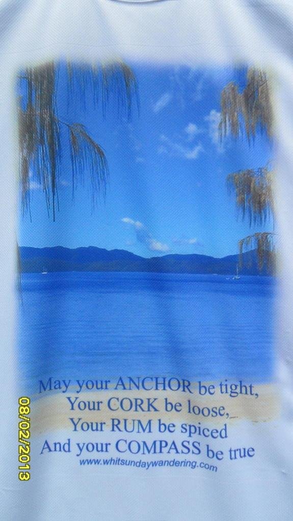

If I want 'artificial pop' I do this with one of my sunrises/sunsets.
[ATTACH=CONFIG]2326[/ATTACH]
vB_ID:2326
vB_ID:2326
Sorry, you must have misunderstood what I was meaning. In a set-up like ours, our final printed colours on the polyester are what we calibrate to with our ICC profile, so that the polyester sublimation doesn't add any extra pop, it just gives the brightness and contrast we expect to see. Depending on the type of polyester we're using it will then either have a matt or glossy look, but the colours are just intense or pastelly as we see them on screen and expect.
I wasn't saying that you were sublimating to a polyester shirt, what I was saying was that your shirts look very similar in their print quality to a 50% polyester/50% cotton shirt, and I supposed that this was in effect because you were coating the cotton fibres of your shirts in a polymer solution, that you were ending up with a fabric similar to a 50% polyester/50% cotton mix.
We don't do t-shirts yet, but do print a lot of 100% polyester fabrics (of different types) for lampshades, cushion covers, and scarves, and I wouldn't be happy if our print quality looked that washed out.
In saying all of this, I am not saying you shouldn't do what you're doing - I am impressed with what you are trying to achieve, and that you've put so much work into it. I am more saying - don't give up, and keep going, as I can see improvements in your work. I do still think you could sort your colour problems out if you had a system able to use ICC profiles, and you had your own profiling kit to be able to make a colour profile specific to your ink/printer/and coated fabrics.
