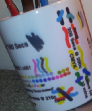

Spent the day testing different times and heat settings, I looks like 200c @ 200 secs is the best for my situation but I don't think I will ever be happy with the results judging by what I have seen so-far.
My new 'lamp' will arrive today so I can post accurate images to what I am seeing but for now my so-called 'Black' is looking better on the cheaper paper as opposed to the xPress stuff - I am finding that anything over the current setting (with the xPress paper) that the Blacks are going brown (Over-cooking no doubt).
I read on here somewhere that you can use the same Mug for many tests - yes, you can BUT every time you heat the Mug the previous 'Prints' get washed out ! so I can't really compare
I am getting to realise that the 'Mug Design' will play a HUGE PART in this lark as I cannot get anything 'Sharp' in terms of what I suppose must be 'Bleeding' ! There's no way I (At the moment) could offer anything for sale.
Not a great image but here we are:
[ATTACH=CONFIG]2000[/ATTACH]
The latest print is the one going from top to bottom.
I notice that RGB colours are head and shoulders above the CMYK - that is probably by design (hopefully

I wrote a post for you yesterday, but it seems not to have gone up, so I'll repeat part of it here.I read on here somewhere that you can use the same Mug for many tests - yes, you can BUT every time you heat the Mug the previous 'Prints' get washed out ! so I can't really compare
The simple way is to buy a cheap 100% polyester bed sheet. Cut it into appropriate sized pieces. Wrap ordinary photocopy paper around an old mug. Wrap the polyester material around the mug and press as normal.
You can check your approximate colours this way - but NOT accurately your temperatures and times. You can see trends though and it is a cheap way to get close.

SG, Your way is how my press manufacturer describes the 'Cold Press' method and is the way I am doing things.. But I haven't tried 240 secs yet at 180 (will do that today with today's 'Test Mug'
I'm convinced this is a Temp/Time issue.

We don't use Sawgrass inks, or TruPix papers, have custom profiles for our printers and screens, and don't use standard sublimation mugs, and still get good results - so don't give up.
We ended up at 200 degrees for 200 seconds on our mug presses, with the timer starting as soon as the press is closed. I think the specs for our sublimation ink states that they start sublimating at 160 degrees IIRC, so the temp of the press is set to 200 degrees to accommodate the temp drop on putting a mug in the press, and how much the temp recovers over the 200 seconds

Janners, there's no 'Teaching Granny to suck Eggs' - I am guilty of assuming someone knows the basics of things I have been teaching in the past and been pulled up about it.
I was trying to log my attempts, by having the time and temp on each successive test but as I was using the same Mug for the test session as soon as I made a new test the older ones faded so that idea (although I thought genius at the time) didn't work
Just the smallest detail can make a huge difference, I'm just looking for what I have missed and I greatly appreciate you taking the time to help me out.
