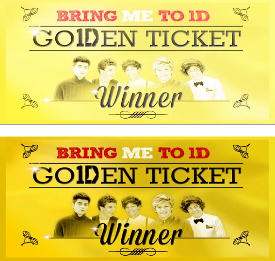

Re: Advice on faint transfers please
Hi Mummywebb
To give you a rough idea take a look at the attached. I have created this in Photoshop as a representation only but will give you an idea of what to look for.
The top image shows how your image will print out when the dye sub settings have been selected and are correct.
The bottom image is how it should dye sub onto the product you are producing
Hope it helps
[ATTACH=CONFIG]1278[/ATTACH]

socialgiraffe;58360 wrote:Hi Mummywebb
Hope it helps
Thanks very much SocialGiraffe that was very helpful and neither my printer nor my transferred image looked like those.
I will check to make sure I'm printing on the right side of the paper, change my printer settings, and press longer and hotter and see what happens.
Thanks again for taking the time to do that.
