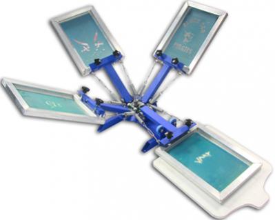

[ATTACH=CONFIG]1189[/ATTACH] Here it is

Looks good, didn't it come with a table?

nope. but you can set it on any table with 4 plugs
