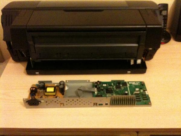

Justin... turns out it's not too bad, mine is now out. You need to remove the two end covers (2 screws in each) and pop them off. Then remove the back cover that surrounds the metal back plate that houses the power supply and main board. Then remove the 7 screws that hold the metal tray in place and it slides out, you need to remove the cables that connect the board as you slowly pull it out. Have a look at this YouTube video, it's for a 1900 but it's very similar and very helpful. You don't have to strip the printer down as much as shown in the video, just the bits I mention above, as you can see from my pic.
Edit.. sorry put wrong link on, this is the correct one!
http://www.youtube.com/watch?v=JQXG9Qq0 ... pr3Vb85UtK
Here's a pic of mine taken out.
[ATTACH=CONFIG]804[/ATTACH]

Re: Epson Photo 1400 for Sale (Spares or Repair)
OK board is out :wink: I see that you have to run a program to get the printer to accept a replacement head....I hope it isn't the same for the mainboard! PM me your address and I'll get it on it's way. Think I'll strip the rest of this 1400 down now...masterclass anyone? Printers under the hammer?
BTW....I hope you labelled all those cables!
