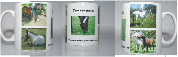

Just my crap photo, lol, the greys look OK, it's just the blues that are wrong, and the pink that came out purple, but that happens quite often :(
Re: Can't get royal blue, any ideas?
most of the colours from palete (squers) are very light coloured. are you sure all your settings ok?? this picture should be much more saturated.

The setting haven't been changed on it, and up until trying to do this royal blue mug, not had any problems, that I'm aware of.
Here's a different mug I made, and colours are all vibrant on that

Been thinking about this, and the colour/saturation problem only occured after I put the new carts in.
Will go do one of my horse mugs and see how that turns out.

I *think* I've sorted it, got a mug in the press just now, give me a few minutes til it's done and I can check it, the colours looked better on the paper.
I'd somehow managed to tick the ICC profile button in setup (don't know how I did that as I never look in there, lol)

It's now sorted, problem must have been because the ICC profile somehow managed to get ticked.
Printed the mug image again, and all colours are nice and vibrant........ and correct colours.
