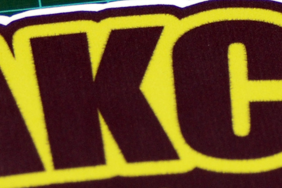

When I say that the colour ran ............. became fuzzy in certain areas, this is what I refer to:
[ATTACH=CONFIG]277[/ATTACH]
- vB_ID:277
- PVinylCRun.jpg (81.45 KiB) Viewed 218 times
- PVinylCRun.jpg (81.71 KiB) Viewed 218 times

smitch6;23031 wrote:is that the paper or the actual printed T Adam?
This is the printed vinyl that was printed on the second run. I printed the artwork and then countour cut it (keeping it on the pastic backing). After having a good look I decided that I couldn't use it.
It looks out of focus but the image is sharp ............... the edges of the letters are "fuzzy" which make the image look blurry ............... again, this could be because I didn't use durabrite inks????

Yeah tried them all Paul, the best setting available got the best print on the first sheet I printed (I tried other settings but the fuzzyness was even worse).
After I printed the next sheet on the highest quality available with only a little fuzziness I thought I had cracked it - then I tried again and this happened.
Paul, do you reckon the ink is the problem or do you think that going through the media options available in the print options might resolve it (don't really want to waste any more money chasing my tail you see).

I think it may be the ink problem. its look like doggy ink mixed with water etc... or... how about greae on the vinyl??? is it possible to hve some greasy marks on the vinyl??? if there is some ink wont hold to the media. i had this with my phoo paper.

It does look like that Paul, but as I say I have printed with the same ink on various types of paper and also other transfer papers - all with perfect results.
The printable side on the flex looks clean enough ................. it must be that this particular brand of ink doesn't work with the printable flex which is dissapointing but not anyone's fault as it does say to use durabrite inks - which I haven't!
I'd be interested to know if anyone has used the flex with durabrite inks though???

It's been a while since I've printed on the printable flex myself, but we did some tests on this back in the D88 days with Durabrite inks and another Epson printer using ordinary inks. The ordinary inks gave the same "fuzzy" effect that you show on the picture, but the D88 gave crisp results with no blead of inks into each other.
