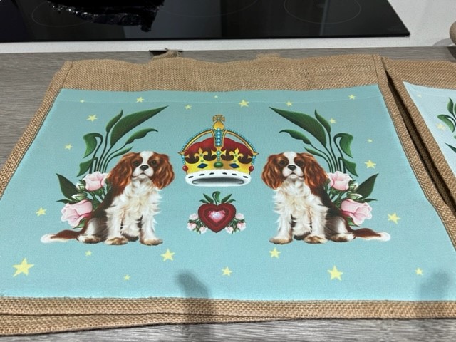

Sawgrass sent out a new set of inks, I did 5 head flushes and this did not make any difference, after a lot of messing around, they sent out a new printer which I have setup and the problem is exactly the same! which tells me it is in settings, they talked me through most of it as they refused to logon and look for themselves which they used to. I am ordering an Epsom but was hoping to run both printers just in case.

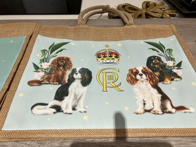

[ATTACH=CONFIG]7160[/ATTACH][ATTACH=CONFIG]7161[/ATTACH]
The one on the right is what we were producing!
vB_ID:7161
vB_ID:7161
Bag Correct Colour.jpg (89.21 KiB) Viewed 297 times
vB_ID:7160
vB_ID:7160
Bag incorrect colour.jpg (96.58 KiB) Viewed 297 times
