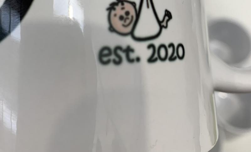

This is another photo of a mug with this issue. We’ve had a small handful of mugs come out from the new batch of wraps with the same issue now so I don’t think it’s the wraps (after just having ordered £640 worth of new wraps!!)
I would be really interested to know what settings / qty’s you use @socialgiraffe so I can try that.
I did wonder if maybe I’m overcooking/undercooking the mugs which is making the ink in that spot gas out due to the dip in the mug but we have also had some mugs with a solid black colour where the black in that area just hasn’t transferred properly as if it wasn’t hot enough.
I’ve also noticed as an aside that some of the mugs appear to be more ‘cooked’ on one side than the other.
the only other thought I had is that we recently changed printer and ink (gone from sublinova sure to inkforinkjet as our old printer packed in. Wouldn’t be that would it?

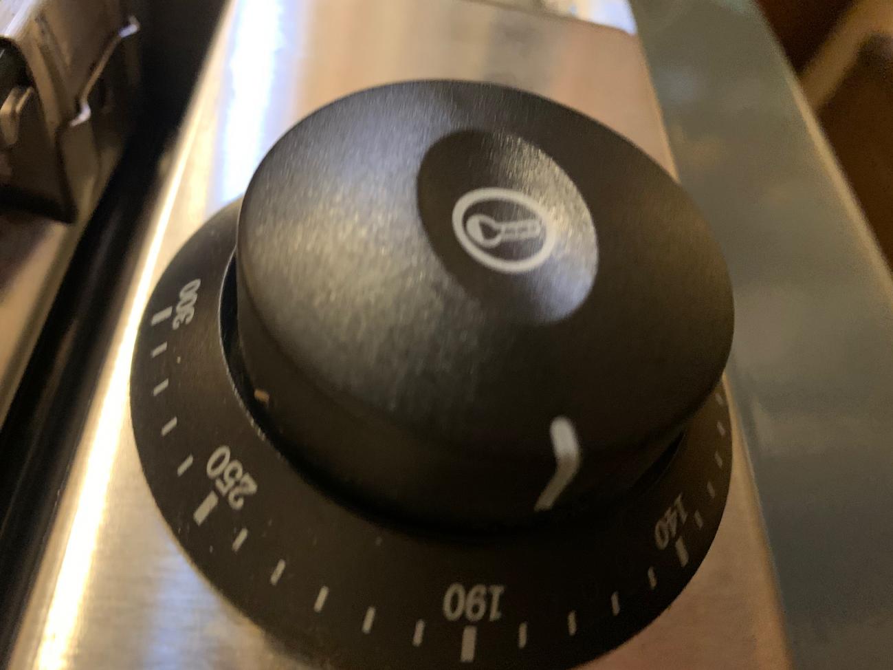

OK, so first things first... please see the image for where my dial is. As the weather has turned slightly and I do not have heating in my unit it would not surprise me if I had to increase the time to around 15-16 minutes. Please bear in mind that I am using better ink (see my comment below), am using a quick release paper from Ink Experts and I am using the best coated mugs from Listawood to get these times. Other coatings in my oven tend to take a wee bit longer (about 18 minutes).
[ATTACH=CONFIG]6391[/ATTACH]

There is no doubt it could be the ink, particularly as you have gone from what most sublimation experts consider the best sublimation ink out there to arguably one of the worst. That is all I am going to say on the matter as the owner of I4I is on this forum and tends to throw his toys out of the pram with lots of false accusations and outright lies and I don't particularly want to get involved with that branch of narcissism tonight
I do think your oven is too low on temp so that is something I would advise increasing. Try incremental steps of 5 degrees.
Although I have no reason to doubt the quality of the mugs you get (never used them) I would recommend either Listawood or Xpres to see if that makes a difference. Again, I recommend Listawood as I think their coating is the best around. However others don't mind a slightly poorer coating for what they consider to be a better mug. Obviously that is a personal choice, but either of those two suppliers are a good starting point.
The "more cooked on one side" comment is worrying. I assume you have tried other ovens and it is not a fault with the oven you are using (i.e. one of the fans has stopped, or the seal on the door has worn)
