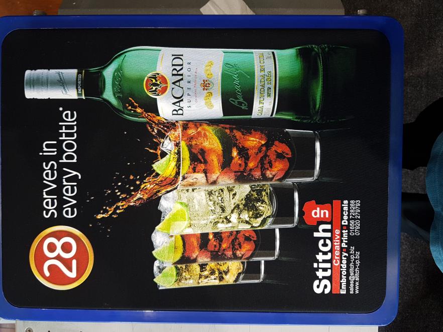

A very happy DTG printer owner Image
Here a few I printed today:
[ATTACH=CONFIG]6259[/ATTACH]
