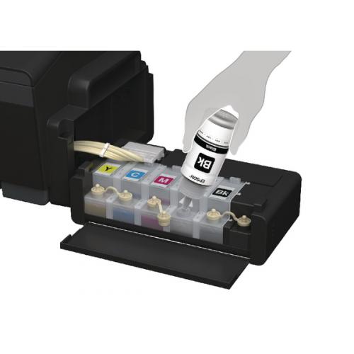

To refill the Ecotank simply unclip from the side of the printer (lift up about 1cm), remove, lie the tanks down on their side, remove the rubber plug and either pour or inject the ink into the corresponding ink tank. Extremely simply. Obviously just ensure the tanks are not left to run out completely, we recommend refilling when they reach 1-2cm from the bottom, but can be filled at any time in-between.

ah so semantics really? Not quite recharge (I imagined an electronic procedure perhaps involving a battery) just refill!

Yes, the printer will 'charge' the ink on its first setup i.e. when the printer is brand new it has no ink in the ecotank or ink feed lines. The tanks are filled with ink and the ink button pressed and held for 5-8 seconds, this initialises the 'ink charge' this charges the ink feed lines and prepares the printer.
This process is only done on the very first power up of the printer. Thereafter it does not need / perform this. Although we do have software that can repeat this process should you ever need it- the ink tanks were left and ran empty for example.
