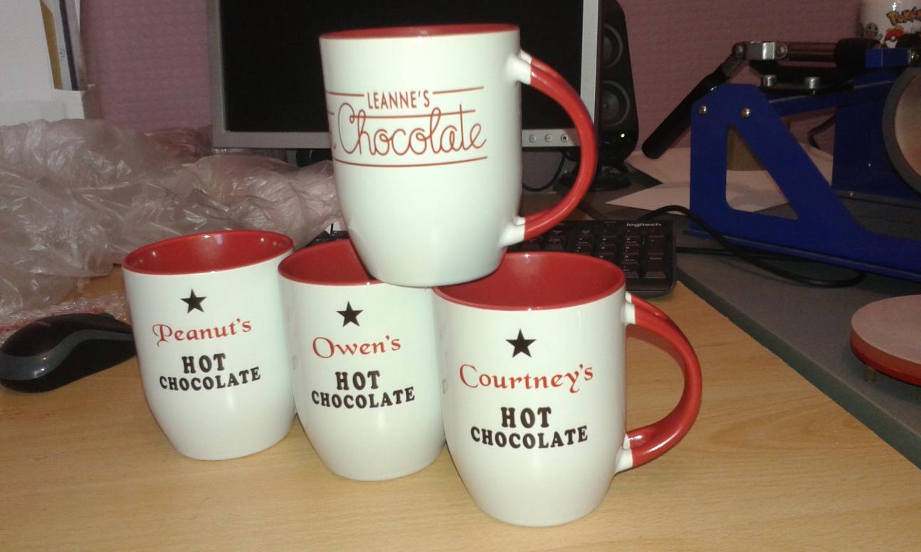

As SG said, doesn't make any difference. I much prefer using the oven now for anything but simple, centred images. Saying that though, I still have to use my presses for the 12oz two-tone mugs with spoons because the clamps on the silicone oven wraps won't fit through the handles. Mind you, I get decent prints on these in the press because the image only covers the top half of the mug due to the curvature of the mugs.
This type ...
vB_ID:5506
vB_ID:5506
2016-11-30 11.17.13.jpg (88.88 KiB) Viewed 10 times
Re: Printing Mugs - Now this is a first!!!
[QUOTE=webtrekker;135252]As SG said, doesn't make any difference. I much prefer using the oven now for anything but simple, centred images. Saying that though, I still have to use my presses for the 12oz two-tone mugs with spoons because the clamps on the silicone oven wraps won't fit through the handles. Mind you, I get decent prints on these in the press because the image only covers the top half of the mug due to the curvature of the mugs.
This type ...
[/QUOTE]
Try some thermoshrink and you might be able to do full top to bottom coverage
