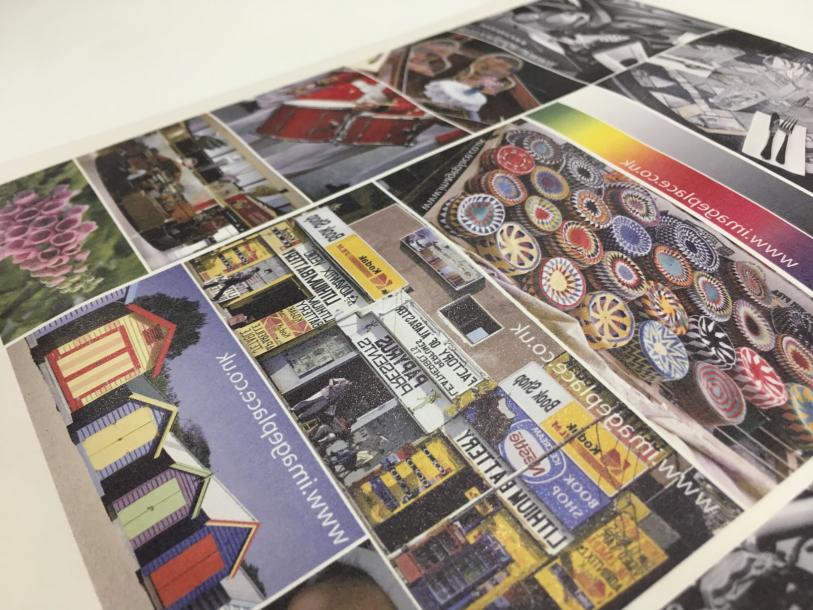

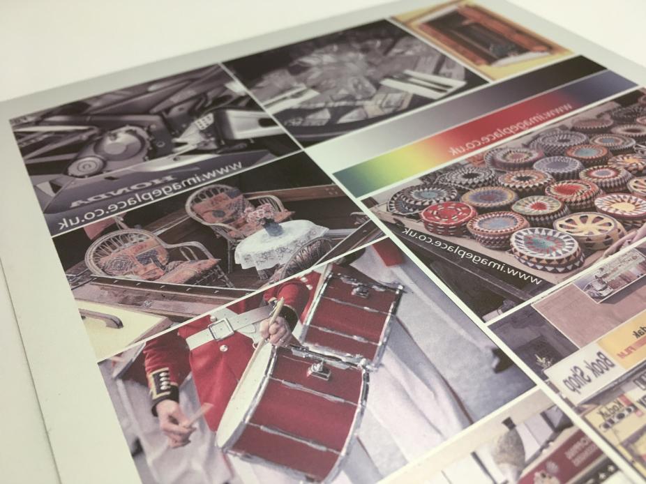

Progress with Epson Surecolor SC-P600-
In our last post we had produced the colour swatch charts for the profile to be made for the SC-P600 using the Inktec Sublinova Smart ink set. The ICC was finalised over the weekend so we set about testing the printer and producing some initial test prints.

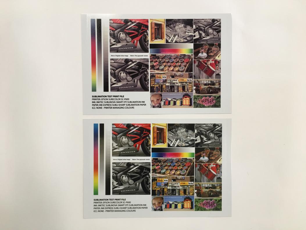

Comparisons-

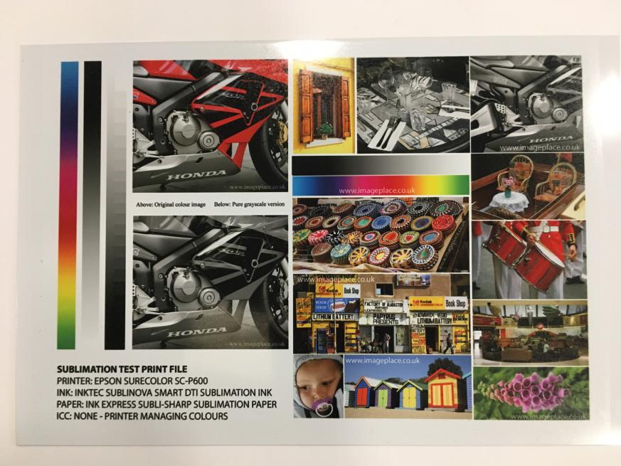

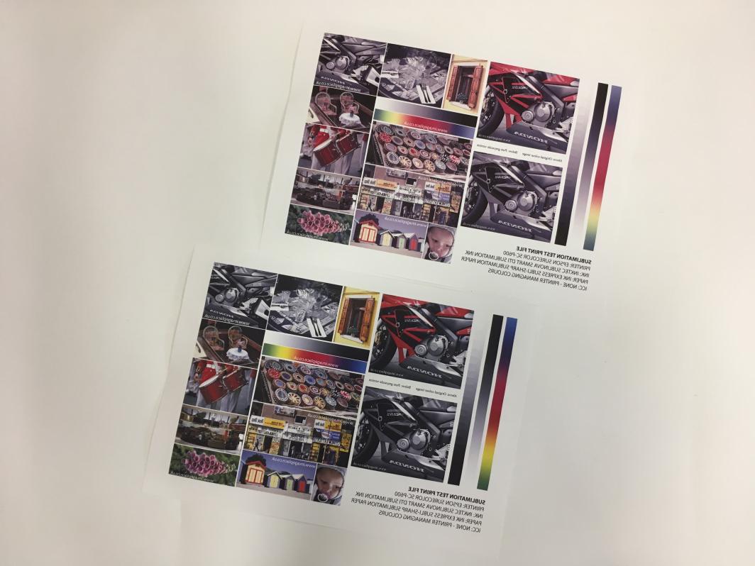

We produced a test print image to test full colour, BW and gradient colours. We printed the image on our Subli-Sharp transfer paper. We produced two test images one printed using the ICC profile and the other with the printer managing the colour.
Below shows the two prints; print at the top is with printer managing colour and print at the bottom is using the ICC profile-
vB_ID:5219
vB_ID:5219

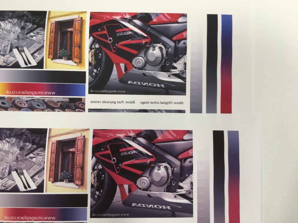

Close up showing a great improvement with reds, the print at the top is with the ICC profile, the print at the bottom is with the printer managing the colour-
vB_ID:5219
vB_ID:5219

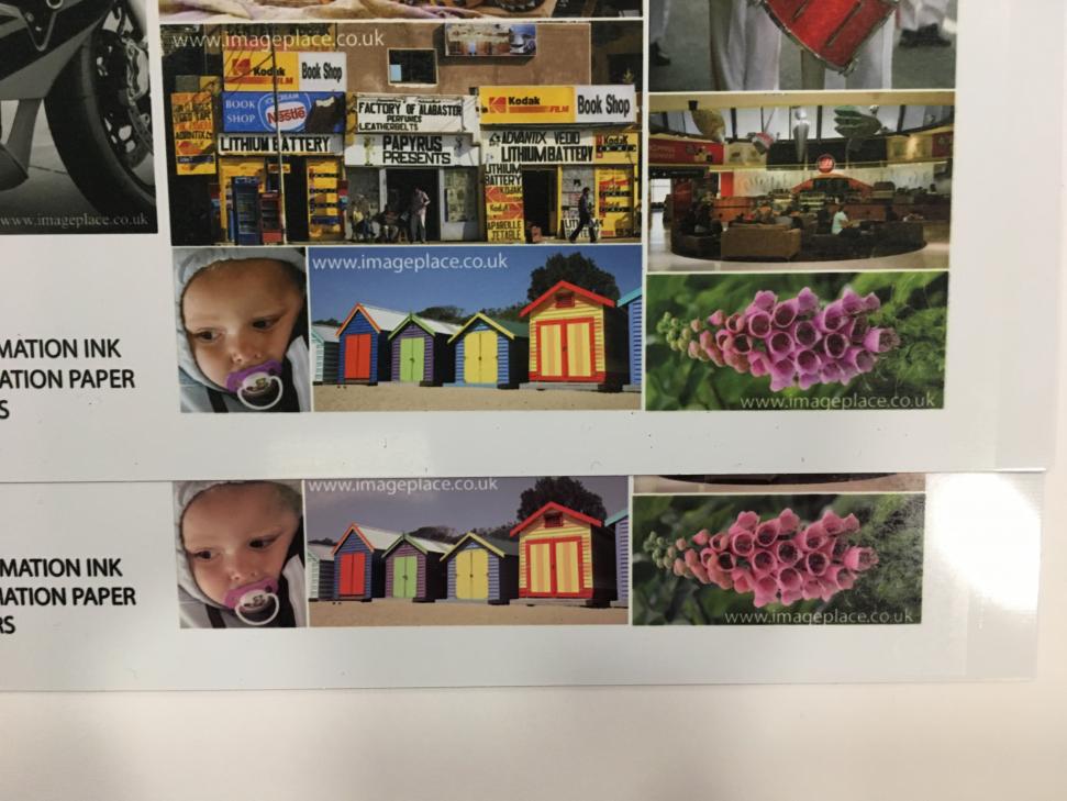

Again improvement on red; print with ICC on the left, print without on the right-
vB_ID:5219
vB_ID:5219

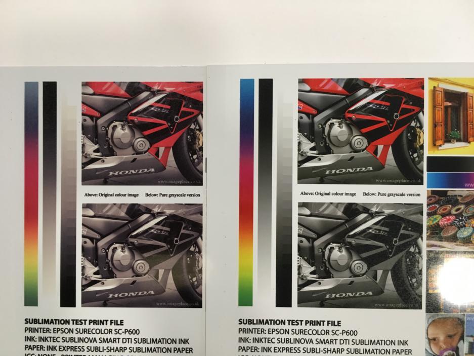

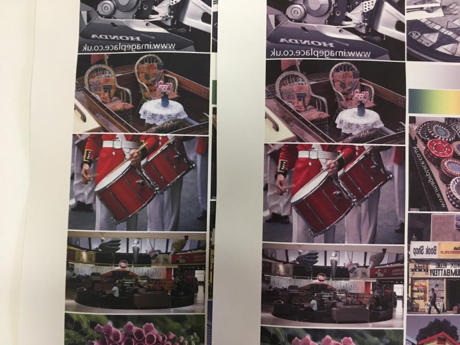

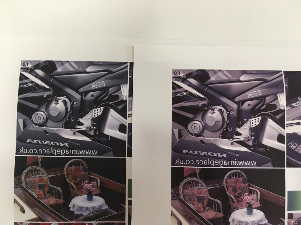

Black and white areas are also improved; print on right is without ICC profile and greys have a magenta hue / cast. The print on the left is printed using the ICC and has improved neutral tone in the black and white areas-
vB_ID:5219
vB_ID:5219
With the test images produced on the paper we then heat pressed on to sublimation coated aluminium sheets, we followed their press instructions and pressed at 200c for 120 seconds. The images below show the two images following heat pressing.
The sheet at the top is without the ICC profile the sheet at the bottom is with the ICC profile; as expected the pressed sheet from the print with the ICC had greatly improved red, brighter yellow, blues and greens-

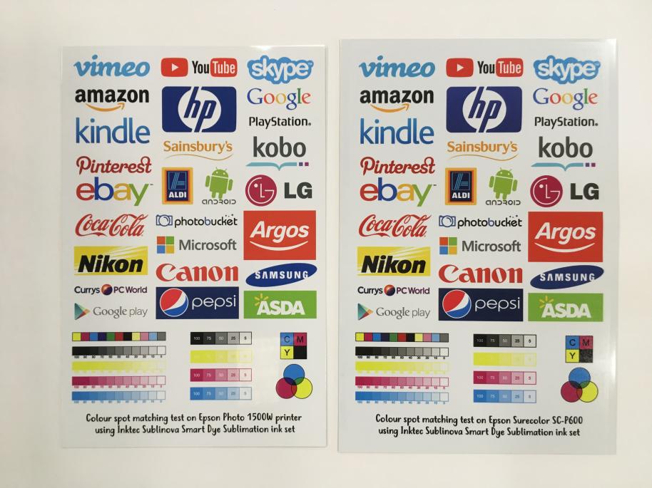

Comparing with the Epson 1500W-
We decided to test the SC-P600 against the 1500W, we found the results were almost identical. Which in a way is a little disappointing, but in hindsight this goes to demonstrate how good the 1500W printer was. The SC-P600 produces extremely similar colours over the color spectrum.
We used a test image comprised of well known blue chip company brand logos as everyone knows how these should look in terms of colour so it is always a good demonstration of the colour matching a printer can produce.
The test images were heat pressed on to the aluminium sheets and placed side by side. There is very very little difference between the two. The SC-P600 has a very slight improvement in the red on the Argos logo and the grey in the Kobo and LG logos is more neutral than the print from the 1500W. So overall very slight improvments but goes to show the SC-P600 is certainly a viable alternative printer.
vB_ID:5219
vB_ID:5219

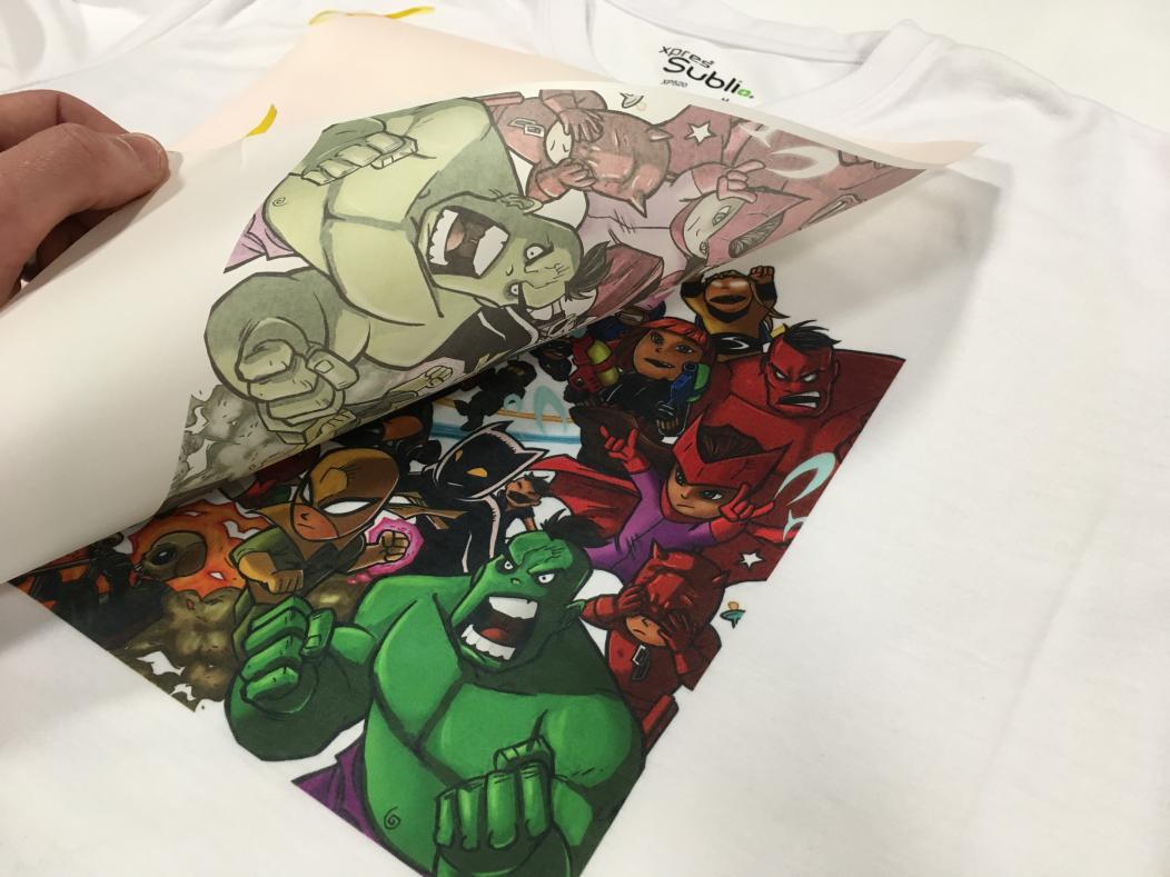

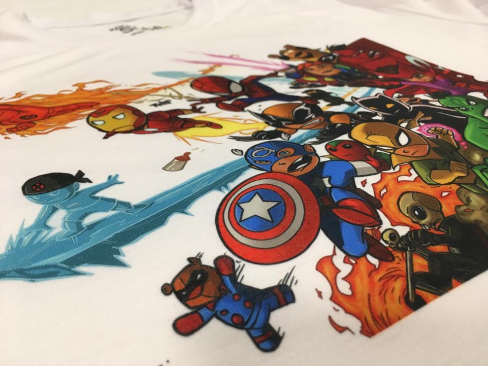

Further testing with Epson Surecolor SC-P600-
Following on from my post the other day we have continued testing the Epson SC-P600, we started by testing it with fabric substrates. We wanted to test a range of fabrics from bright white 100% polyester t-shirts, to off white and cream polyester linen and canvas.
Testing on a range of fabrics should demonstrate how the printer, inks and ICC profile will perform in any given situation.
We chose to use a nice high resolution, colour, comic image as this will demonstrate the colour range and vibrancy of the final transfers. We used the same image for all fabrics and all were printed using our Subli-TEXTILE High Release sublimation paper to keep things consistent.

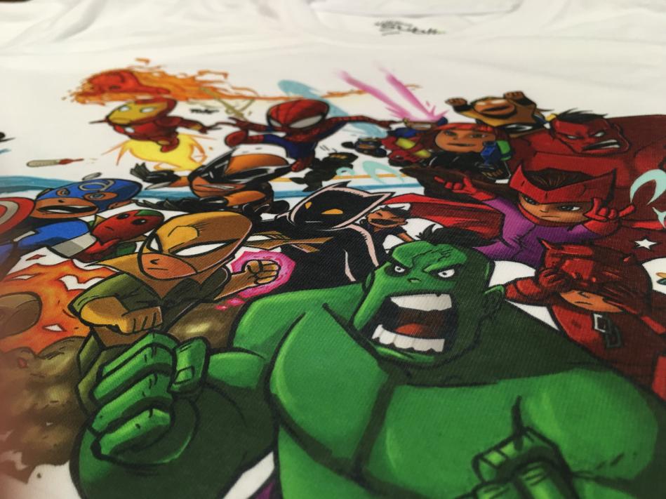

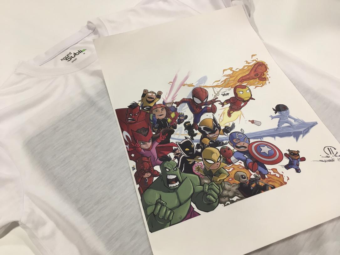

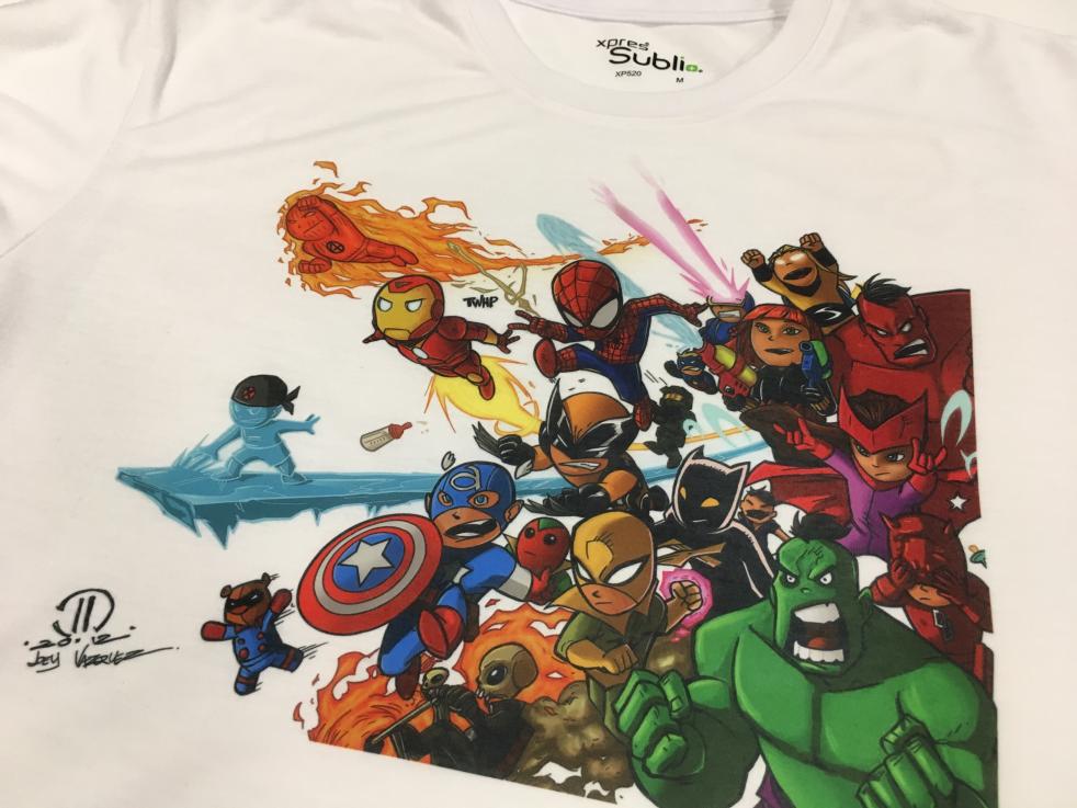

Bright white polyester t-shirt-
We started off with the bright white 100% polyester t-shirt. Pressed at 200c for 50 seconds.
Print on the paper prior to pressing-
vB_ID:5252
vB_ID:5252
Paper transfer removal-
vB_ID:5252
vB_ID:5252
Final outcome-
vB_ID:5252
vB_ID:5252
vB_ID:5252
vB_ID:5252
vB_ID:5252
vB_ID:5252

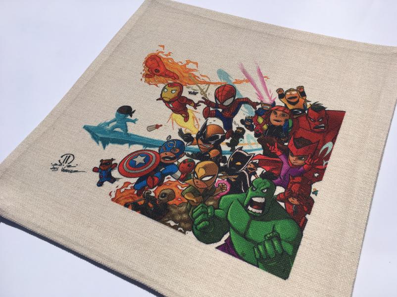

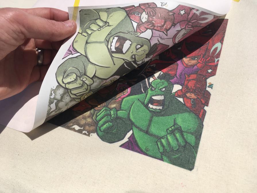

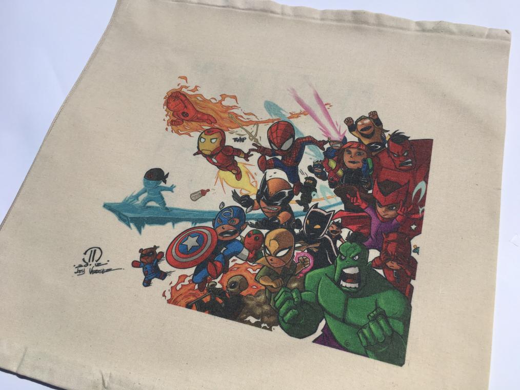

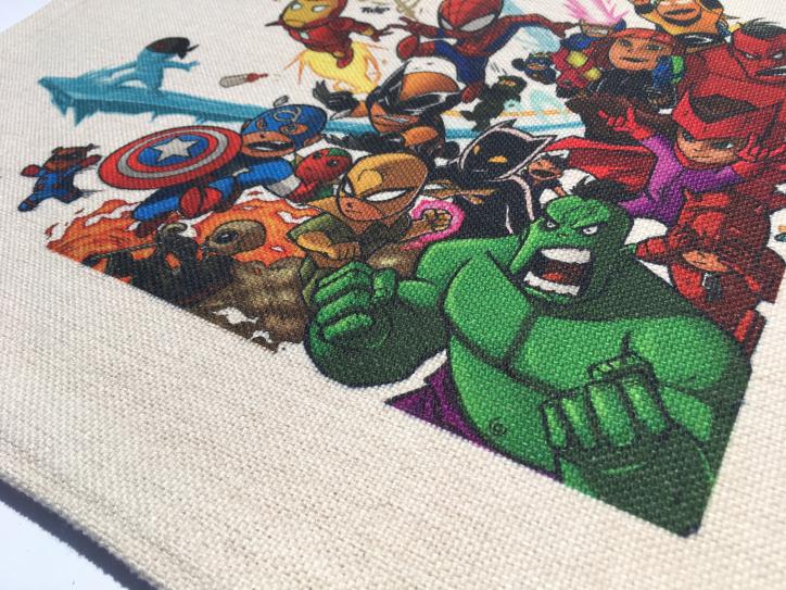

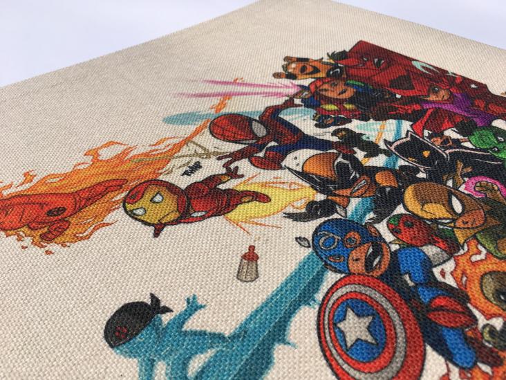

Linen Cushion Cover-
Next up was a cream linen cushion cover, these have a deep fabric weave and a lovely feel and texture. Pressed at 195c for 120 seconds.
vB_ID:5252
vB_ID:5252
Final outcome-
vB_ID:5252
vB_ID:5252
vB_ID:5252
vB_ID:5252
vB_ID:5252
vB_ID:5252

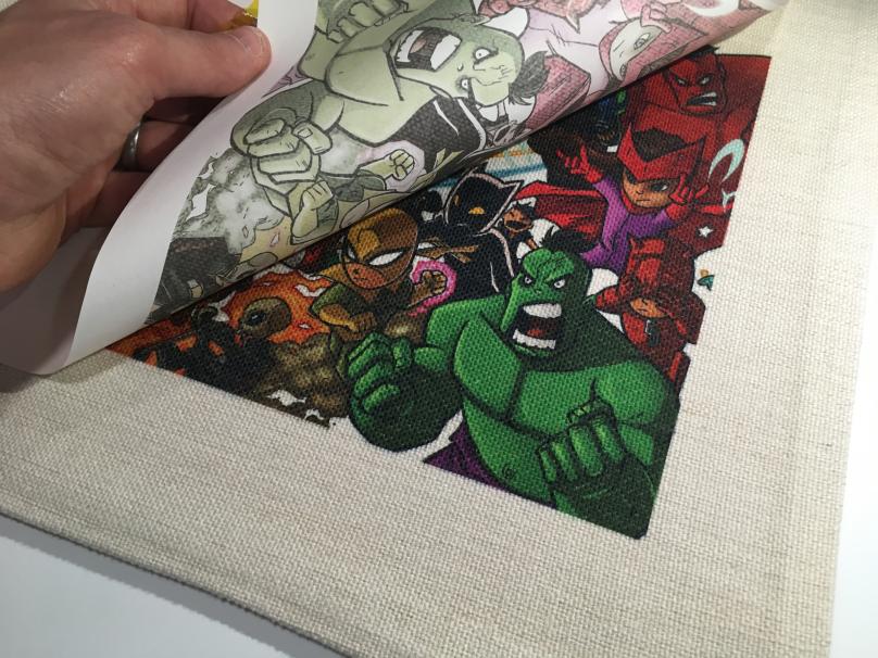

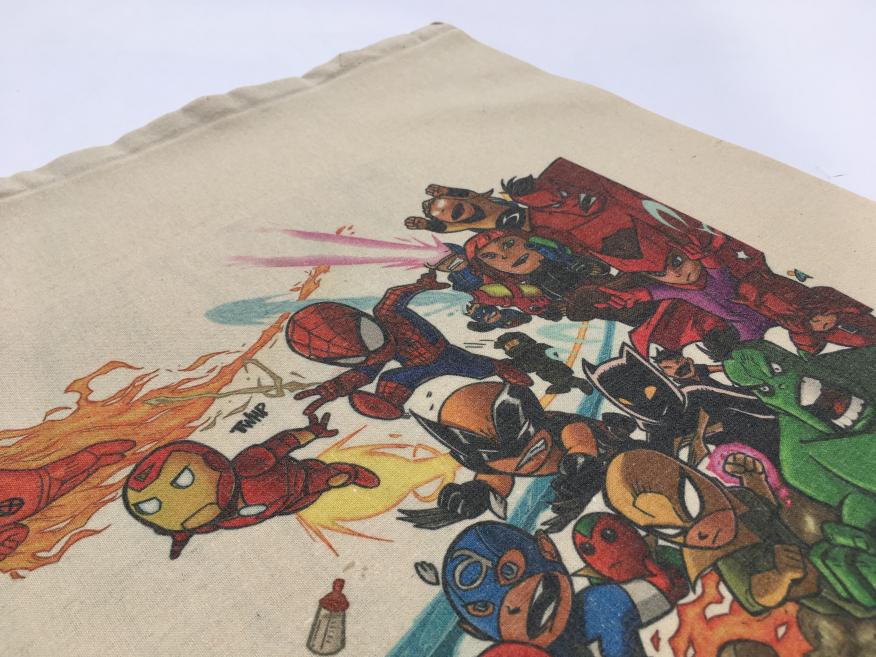

Canvas Cushion Cover-
Last was the canvas cushion cover, the canvas covers are a much cheaper material than the linen. They have a closer fabric weave and are a darker cream colour so will typically give the dullest final transfer. Pressed at 185c for 90 seconds.
vB_ID:5252
vB_ID:5252
Final outcome-
vB_ID:5252
vB_ID:5252
vB_ID:5252
vB_ID:5252
vB_ID:5252
vB_ID:5252

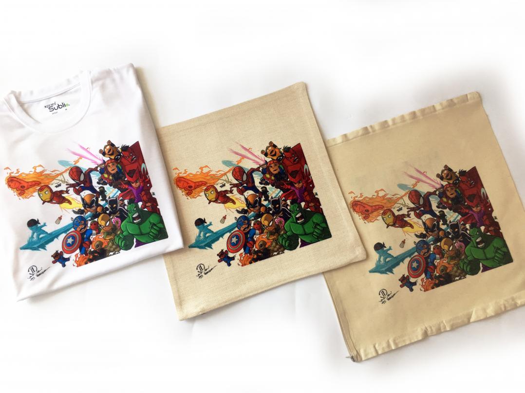

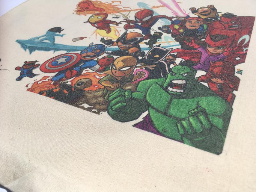

Comparison-
Naturally the bright white t-shirt gave the best result with the brightest and most accurate finish. The linen cushion I was personally really impressed with given its cream colour and dense fabric weave. As expected the canvas cushion gave the dullest final transfer but still good and ideal for vintage designs.
vB_ID:5252
vB_ID:5252
Its safe to say that we will be moving forward with supplying the Epson SC-P600 for dye sublimation, hopefully we will start to roll them out in the coming weeks.
