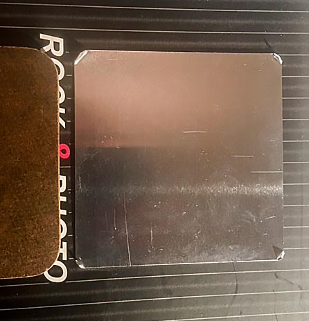

It seems that having some other material on the back to protect it from the tape may work. Obviously any adhesive would probably make it worse. I have a small warco guillotine and cut out a piece of sub aluminium just under the coaster size. Bending the corners inwards creates a "claw" that locates on the 4 corners. As the coaster corners are radiussed the bent tabs prevent the coaster moving in the cover. The cover is placed on the coaster back and located/taped as usual. It only takes a couple of seconds to pop the cover on/off. I guess you may need 3 or more sets for uninterrupted pressing. The ally plate may affect pressing time as it acts as a heatsink, however this can easily be adjusted as it will be a constant.
Pic shows simple (crude) mockup just to prove the point and to show the principle. Subli metals will be able to cut the blanks to your spec, I am assuming that not all manufacturers make coasters the same size...
