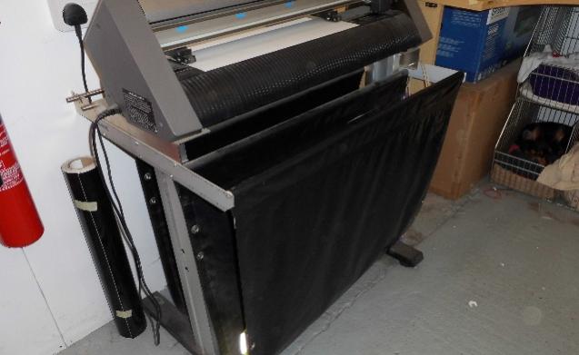

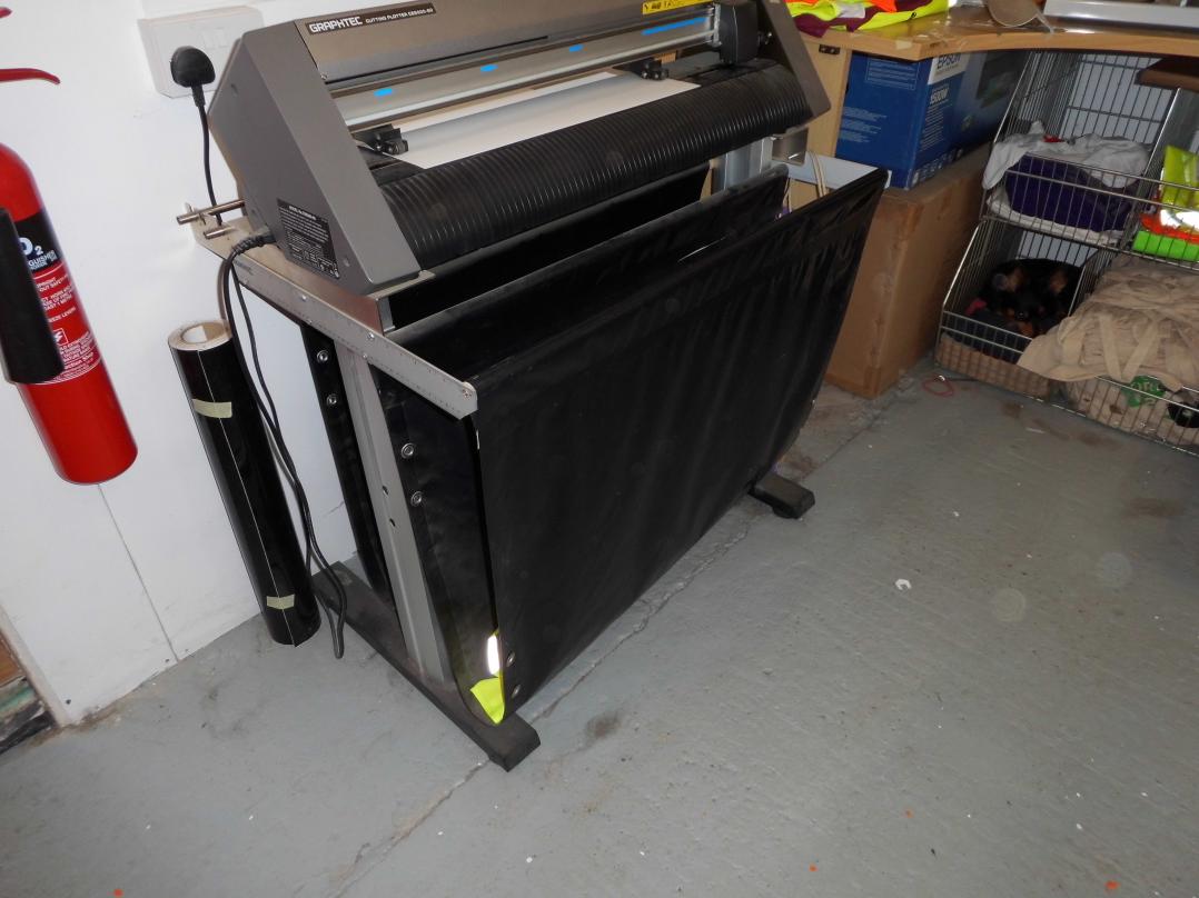

Old post but still a great cutter - I assume the CE7000 is just as good. The only problem I have had with mine is the optical eye is hit and miss.
The media basket is obscenely expensive at £400, so I made my own for £25 from 10 ft of banner vinyl, 4 broom handles and a 1 metre aluminium ruler.
