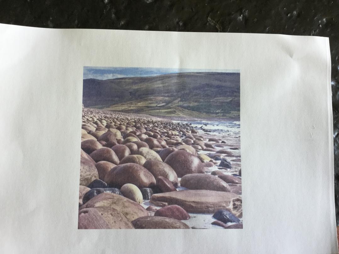

Secondly, can you post a picture of one of your prints. All i want to see is the amount of ink on the paper. That will give a good indication as to whether the printer is laying down too much ink

I did think previous cartridges lasted longer yes it is the first set of cartridges ror this particular printer, you could have hit the nail on the head. Yes they all run out different times. I cannot get the attach a picture to work
- vB_ID:4706
- IMG_3055.jpg (96 KiB) Viewed 348 times

OK, Personally I think the picture seems a bit rich, but others who print photo slates might say this is normal for slates, one thing I do know is that it is certainly not over the top rich and indicating too much waste ink.
I think its right in that as these are the first set of carts for this printer then most of the ink has been used up filling the tubes. The only way to see if this really is the case is by replacing the carts as and when with new carts and hoping that they last longer.
But I think I can say with 95% conviction that as you are using a new printer with the Sawgrass power driver and not laying down too much ink (as indicated) then there is no problem with the printer or the ink, it is just a case of new "printeritus" where you have just spent £180 to fill four tubes
