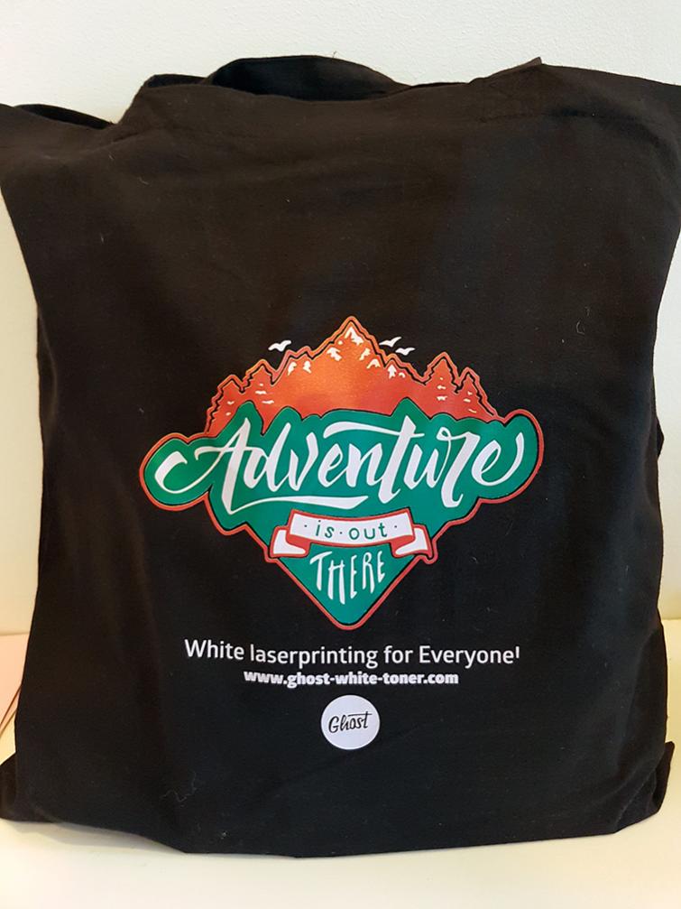

I took home a tote bag with colour print so will dig out and post photo later.
- UK Printed Mugs
- Posts: 2229
- Joined: 21 Aug 2014, 09:58
Re: Spring Fair NEC - Anyone going as well?
Here is a photo of their tote bag. This must use the whole colour range of Ghost toners rather than just the white toner which we bought with the HP printer bundle. With the £250'ish bundle then this would allow printing using white toner only (which is what are requirement is) although if you're printing onto card then of course the regular toner colours are fine to use. And yes I am presuming that if printing onto dark colours you would print layer of white then colour on top. This for us opens up a whole new world of options because the Oki route wasn't something we wanted to invest in.
