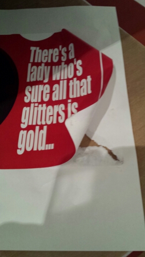

Very good that you are here to respond to specific issues with your papers, however I think that the issues Dave is having need a more specific answer. If you look at the images he has uploaded, when he peels the transfer from the backing sheet it starts to rip as if the backing sheet is stuck to the transfer. If I were to offer an opinion it would be that the transfer is passing through the OKI to hot, but then I do not use your papers so could be well out.
I know that Dave is using a 610 so would assume he is using your recommended settings also, so what else would cause the backing sheet to stick to the transfer?
I have included Dave's original photo below to save you trawling through the threads.
[ATTACH=CONFIG]2059[/ATTACH]
