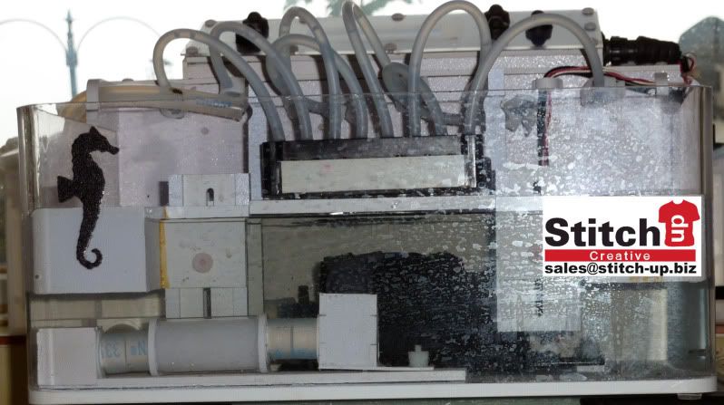

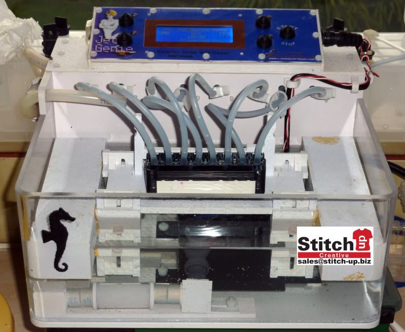

So I removed the printhead and manually tried to release the clogs! I spent literally hours without success :( . Now I purchased a unit called the Jet Genie for just this event, but guess what, parts on that failed before I'd even used it once! I'd removed the parts and returned them to the USA for replacement but I had some shirt to print and just had to buy a replacement printhead - what a trial that was too! Anyway, £350 lighter the printhead arrives and fitted and hey presto, printing again :)
A few days later, the replacement parts for my Jet Genie arrive and I assembled the unit, filled it with 3 litres of cleaning fluid, placed the old blocked head in the float. I programmed the Jet Genie to run for 12 hours - acoustic vibration, irrigation, pumping, sucking. I stared in amazement at first as I saw the ink being dislodged from the head and 12 hours later, a printhead that looked brand new :)
The Jet Genie with all fluid lines attached.
......... and from the front - the surface of the printhead is about 2mm below the surface of the fluid.
Fitted the old printhead back in my printer - absolutely perfect :)
£350 lighter but I have a spare printhead, so I'm happy.

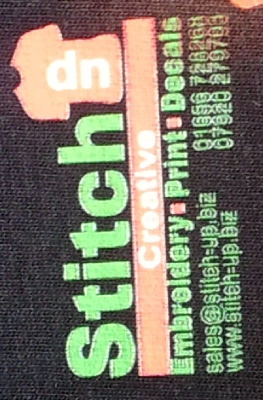

Time is something I don't have in abundance so I didn't get round to carrying out the adjustment until last Saturday! Never having done these alignments before, I took my time to make sure I got it right. Nearly 6, yes SIX hours later, I'd cracked it and achieved a perfect alignment pattern. All that was left to do was to save the new settings and then I pressed the WRONG button and lost the lot :rolleyes: Good job there wasn't a mallet nearby!!!!
I left work early today and started the whole process again, this time it took me just 90 minutes and this time I DIDN'T press the wrong button.
First test shirt printed and here's the result printed on a Gildan T.
