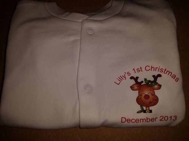

to get back on track of the original post, After lots of testing ive finally come to a conclusion, i have a box of TTC here and i like its final print but i think im going to start purchasing XPRES TRIMFREE for white garments, ive been using it today for some babygrows (xmas present) and i can honestly say ive had less problems with TrImfree and great results.
here is one i did today.

Re: Yolo v TMT v xpress v etc
Trimfree is superb. I've been wash testing and its washing really well.
Dave271069
Posts: 1134
Joined: 26 Apr 2012, 22:44
Post by Dave271069 »
have to agree Justin, only problem is ive used up all my sample packs now so looks like its time to purchase a box/pack
